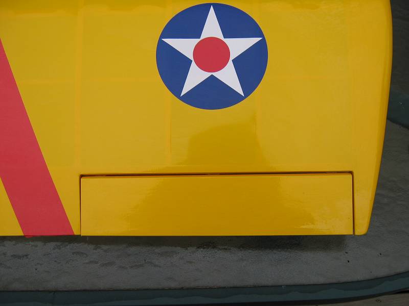

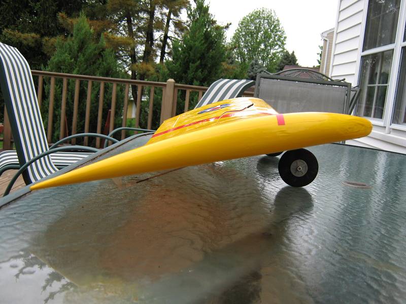

Old 05-10-2008 | 08:31 AM
Posts: 763
From: Manchester, NJ
Default RE: Slow Poke?
Attached are pics of the Slowpoke wing after modifying to include ailerons.
DaveB
