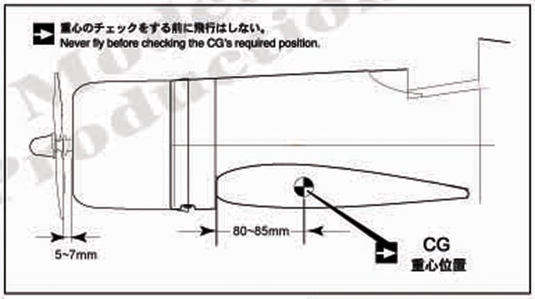

Well I made the mistake of buying a less than reputable brand warbird for my first build, so the already shotty Manuel didn’t come with a cg location. Not knowing the proper cg point, I improvised by looking at a different brand, but same size and identical model, cg point. Well what’s really odd is it takes about 10oz of counter weight at the very rear of the plane to get the correct "hypothesized” cg. I was just wondering if that much weight is just insane since it seems to me adding quite a bit of weight to the plane. Oh and this plane is and fu4 corsair .50 size being powered by an evo 1.00 nx, this is the airframe I bought http://www.nitroplanes.com/f4ucorsair5055.html .

Default RE: Cg issues
If it's the Nitromodels Corsair 50 the Cg should be 80 to 85mm back from the Leading edge at the fuse.
Look at you manual again:

BTW 80 mm= 3.1496062992125986 inch and 85 mm=3.3464566929133856 inch

Now do i measure 3.24 inches from the leading edge at the wing tip, where the wing is thinnest, or do I measure 3.24 inches from the leading edge near the fuselage where the wing is thickest.

Measure distance back from the front (leading edge) of the wing right next to the fuselage of the plane. NOT at the wing tip. Some planes are measured at the tips and that will be called out in the manual if it is the case.

lol i just realized the original link i had wasnt working rite, was the number you gave me for the cg for a evergreen or cmp f4u. < i have the evergreen, if u want to look at it i corrected the link issue.

Ok, DO NOT use that dimension, that is for the CMP model.
However, yours is only 3" shorter in the wingspan, so it will be close to that anyway.
I would give an educated guess and say that if you balance it in the 75 - 80mm range it should fly well enough for you to decide from there if you want to change it.
