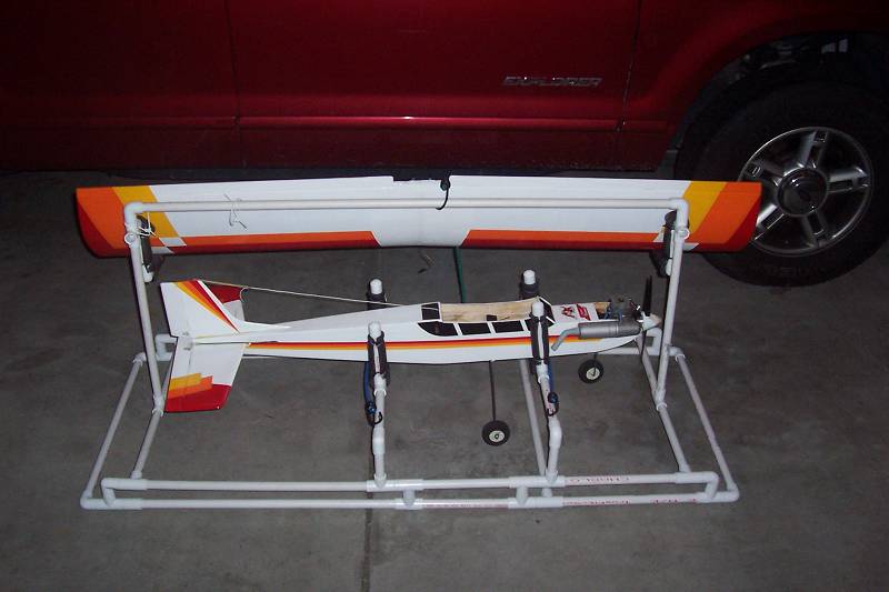

I have been using this rack since my first year. It has held up for the better part of 5 years, and hundreds of trips to the field. One tip, when attaching PVC fittings, don't glue them, screw them with slef tapping screws, that way, as your fleet changes, you can change the rack. PVC pipe is cheap, but the fittings will break the bank. This rack has hauled 15 to 20 planes, ranging in size from .40, clear up to my 25 pound behemoth coroplast gasser. Sits in the back of my short box, and secures with bungee.

Deadeye: Got any pics of the other side. Can't see the fittings and how you tied into the other side.
Gonna copy, copy, lol.

Jim, here ya go. I can haul my TF Cessna 182 assembled in the taller and wider section. It weighs 14 pounds, and saves me about 20 minutes assembling and dissambling at the field. My field is only about 3 miles away, but the last mile is gravel and bumpy field roads. That wider section is also removable so I can put on a skinnier section for skinnier planes. The two black ended pieces butt against the inside of my pickup box, where I have eyebolts to attach bungee cord to.

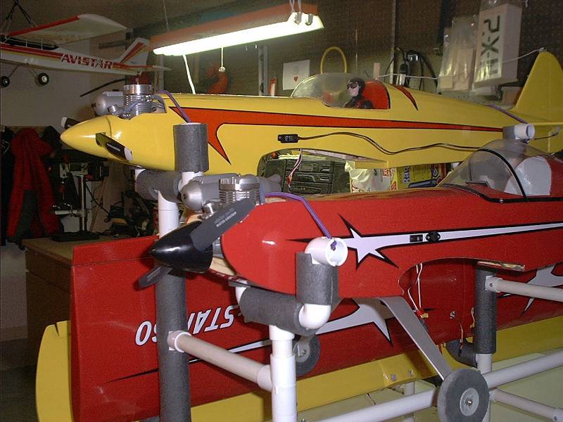

Here is the transporter I built. It has worked out great. Not only does it protect my plane in transport but I use to store my plane from the ceiling on a pulley system. You can easily make a system to transport and store 2 - 3 planes. PVC is awesome. I used 1/4 inch PVC and PVC foam for cushion to protect the plane.
