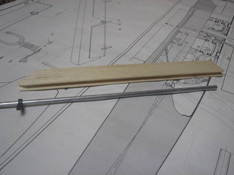

now i have another question, i need to glue steel to balsa and i have no idea what glue will work good for that, and it needs to be strong, i took a pic of what i need to glue just ask if i should take more pics
thanks,

You could use thin CA. Rough up the contact surface on the steel a little with an abrasive like steel wool. Give the adhesive something to grip.
