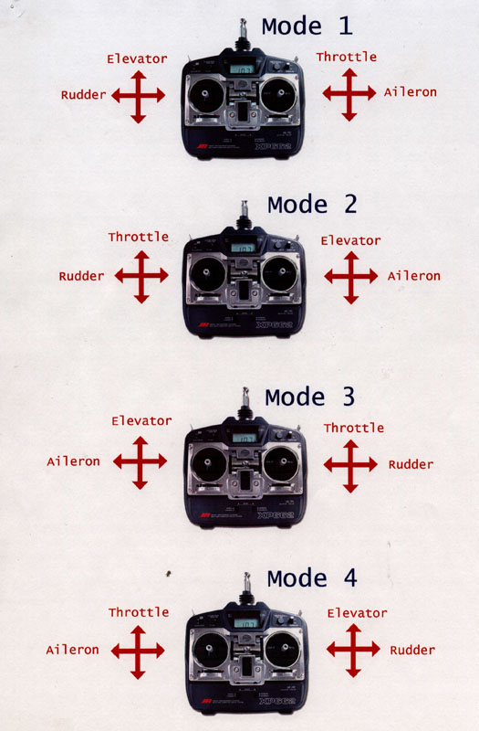

Mode assignment is just a matter of which gimble and which of the two imputs on each gimble affect which of the basic four control functions. It has nothing to do with model strorage and limits of each function that we have selected for each particular model.
Flying on different modes is unadvisable beyond just making the changover, In North America the most common stick mode used is mode 11, Its not clear which mode are you flying?

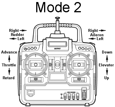

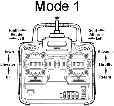

With your control sticks in "Mode 1" the throttle is controlled by the right stick.
With your control sticks in "Mode 2" the throttle is controlled by the left stick.
Which stick controls your throttle LuftwaffeOberst?

Left.

Then you have a Mode 2 radio like most of us. Unlike what you stated in post #4. Just wanted us all to know.

ORIGINAL: bruce88123
ID:	714280   Click image for larger version
ID:	714281   Click image for larger version

I have Mode 2 Ken, and yes the radio can store up to 10 from what I read last night in the manual.
