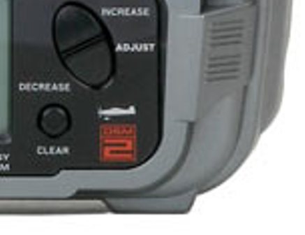

it does show in the manual the different switch positions for heli and plane versions.
[link=http://www.spektrumrc.com/ProdInfo/Files/SPM2710_DX7_Manual.pdf]http://www.spektrumrc.com/ProdInfo/Files/SPM2710_DX7_Manual.pdf[/link]
also heli one has a small heli pic bottom right of the screen where as the aiplane version has a airplane
