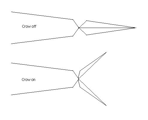

It can also be 2 piece rudder or 2 piece ailerons which split open on command.

It's used a lot on sailplanes. A good state of the art sailplane is so aerodynamically clean that without either spoilers or crow, they are almost impossible to land. Put the nose down a few degrees to steepen the glide slope and the plane just speeds up like a car coasting down a hill and trying to flare just causes the plane to balloon back up in the air.
