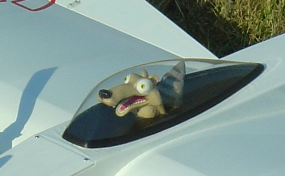

Hello!!!!
In my Uproar the Canopy have a balsa base covered with black vinyl, the Canopy is glued to his base with Canopy glue, the edges are covered with a strip of black vinyl. The pilot (Scrat) is screwed, and all canopy ensemble is glued to the fuselage with CA.
Escipion
