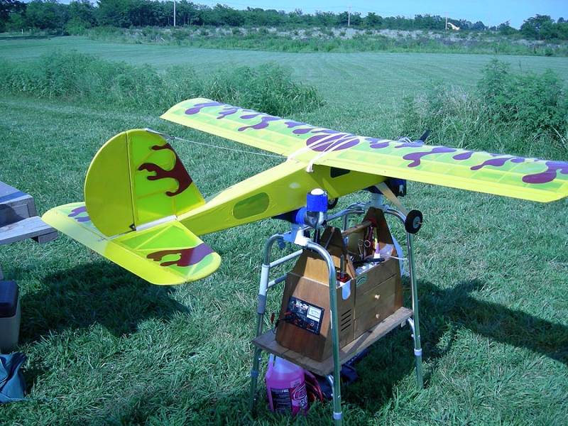

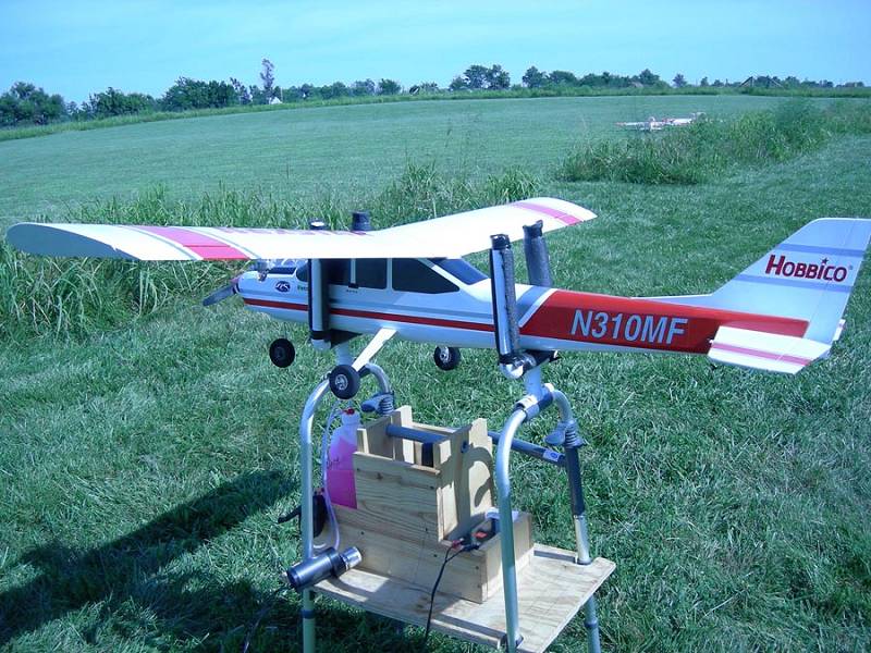

most flyers have some sort of flight stand for working on their planes at the flying site. here is a good one. garage sales or flea markets have these walkers often and i never pay more than 10.00 for one.WOW DON'T KNOW WHY THE PICS LOADED THIS WAY BUT CLIC ON EM AND YOU WILL GET SOME SUPER DETAIL![:-]

well you know you just gotta do what ever works for you. but these stands build in one night and cost less than $20.00, they fold with a push of a button they are completely fuel pruff and the plastic pipe cradles are not fixed so you can change em to suit any plane.
a simple L shaped rig works nicely for profiles or SSC fighters or flying wings.
and you have no idea how many "OLD FART" jokes they can inspire!!

How are the vertical supports attached the top of the walker... I can't tell from the pic... great idea!

the cradles are 1" schedul 40 pvc. a "T" is cut and bolted with a couple bolts with locking nuts to the walker . shimmng a little to fit the walker helps. the actual cradles are not glued into the "T" fittings so they are interchangeable. customizing to fit your planes is easy. the guys at my flying field picked up on this idea and some handy modification such as hangers for transmitters and the like have shown up.

Great... didnt see the bolts... I'm off to "good will" .. they always have a couple there!
As I look I may even add a piece of horizontal pvc into "T's" between the two uprights (below the "U" holding the plane) to take some stress off the pvc and bolts.

be sure to use schedule40 (heavy duty) pvc. that has been plenty strong for up to 60 size birds. be careful to keep it foldable[
