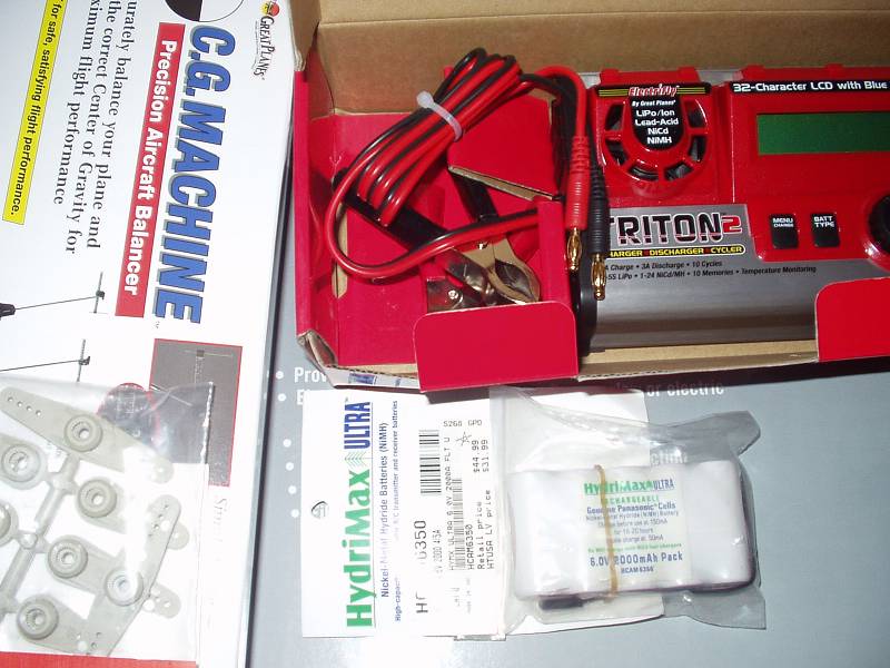

Wow, the battery area is brutal. I found the place to go now but the first thing I pull up is some guy putting together what looks to be an old computer power supply and turning it into somekind of battery gadget. Way over my head. I just want some answers on plugging chargers and 12V batteries together. Maybe I should just ask the questions in this forum. I leave for flight school in about 2 !/2 weeks and gotta get at least enough knowledge on how to charge my reciever pack I just bought. 6 Volt 2000mah off a triton 2 charger with no hookups. AR7000 receiver with JR ST126MG servos.
The Plane shots are what I'm flying at flight school. The twist battery pack is what I need help with.

OK, this is a beginner forum. What questions?
But right off the bat, there will only be two 12V batteries that can be involved.
One is the battery that feeds the Triton. The Triton is sold to be connected to a 12V power sourse. Hook it up to your car battery. That's the idea. And the big line with the alligator clips does that job.
Another 12v can be a flight box battery or the battery in some of the engine starter setups. Some of them are 12v lead batteries. Some have a cluster of 1.2V NiCds that often are 14.4V in total. The triton will do lead batteries. The booklet gives a rundown on that. But basically how you use a triton is fairly simple.
With any charger, you need a connector that hooks to the charger. The Triton uses bananna clips on the connector to the Triton. The other end has to be a clip specific to the battery, or for the wiring harness of the airplane, or for the item (engine starter with self contained battery). Hook all that up and the Triton takes a couple of button pushes to work.
Basically you press the button that's for selecting the kind of battery you want to charge and you do just that.
Then you have to dial that round button to the appropriate amperage for the battery. This takes some understanding. Look in the booklet, it's a page worth of words to get across.
Then you push that dial like it was a button.
And after awhile the Triton beeps at you and you unplug it all.
Didn't see any questions, so ask away..................

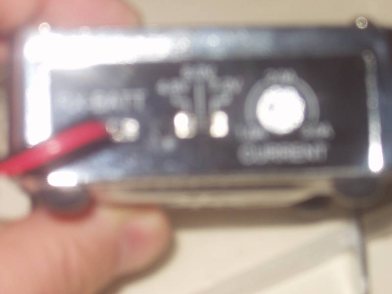

I went and found the spot that the DX-7 reads the volts, thanks. I've got it charging now. I guess I forgot to turn it off last time I had it on. It's funny how I never really noticed that before you guys said something. Thanks.
I also have a Futaba battery checker/discharger that I got off the classified area along with an Apache smart charger for 50 bucks. The last time I used the checker it didn't seem to work. I may have to get a new one.
I'm still not quite clear on whether or not I can hook up more than one charger to my car battery at a time. Lets say I get the Hobbico charger you are talking about and want to use both chargers at the same time. Can I hook up the Triton and the Hobbico charger to my car battery at the same time? Also I noticed at least five different "power points" inside my airplane bus SUV, are these good for anything having to do with airplanes?
