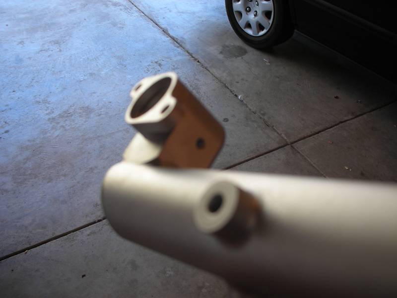

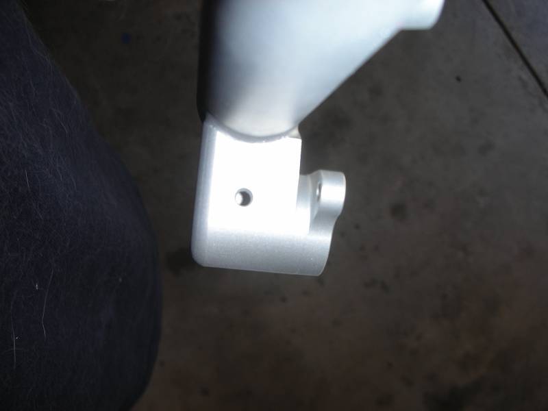

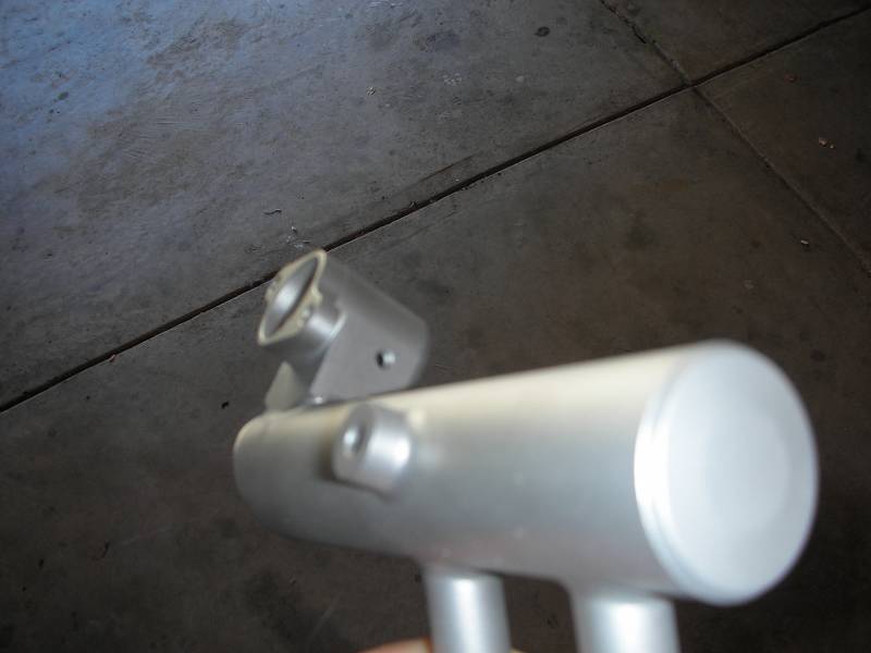

Hi guys,
Thanks for all the responds. Here are some pictures of what I was talking about. You can see both the protruding hole and the one on the side of the intake.

Old 08-12-2007 | 06:17 PM
JohnBuckner's Avatar
Posts: 10,441
Received 11 Likes on 11 Posts
From: Kingman, AZ
Default RE: Need Help With A Slimline Pitts Muffler
The smaller hole on the header portion is in a position for an effective muffler tap to provide pressure to the fuel tank if you choose to use it that is where I would locate such.
The larger hole is centered to the outlet pipes and likely an intended point for smoke oil injection to provide uniform smoke from both outlets. If you have no smoke then plug the hole.
Do not plumb the crankcase vent to the muffler, leave it open to atmosphere or just a length of fuel line to clear the cowling if you like.
John

Old 08-16-2007 | 10:11 PM
My Feedback: (7)
Joined: May 2005
Posts: 792
From: San Jose, CA
ORIGINAL: rloeb
The larger hole is for mounting a bracket that holds the muffler to the motor.
Rog
Just wanted to give an update. It turned out that the protrudung hole is indeed for a mounting bracket, that does not apply to my application and the hole's size is 10-32. The smaller hole is for the muffler pressure nipple and its size is 8-32.
