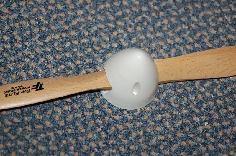

I am installing my prop again after some repairs. I fly a sig rascal40. I always had this question. Does the prop have to be touching ,leaning against the plastic stubs OR against the Stub where the nose cone screws in? My assumption is that as long as the prop is tight enough it dont matter....
Am I right ? See image. Here this is what I did, it is very tight but not resting against any of the 4 stubs...
TIA
--747

The forward edge of the propeller should be touching the small peg. This is an alignment peg in order to be able to secure the forward part of the spinner. You need to reposition the prop to the other side of the small peg in your picture, then rest the forward edge of the prop against the peg

Ken, I think it's the BACK edge of the prop that should be against the small peg. Easy way to tell though, the spinner won't go over the prop and fit together snugly if it's not lined up right.
ho2zoo - you are correct. The trailing edge of the prop should be touching the alignment peg.

yep, acourding to the picture looks like you have it correct, just make it really, really tight

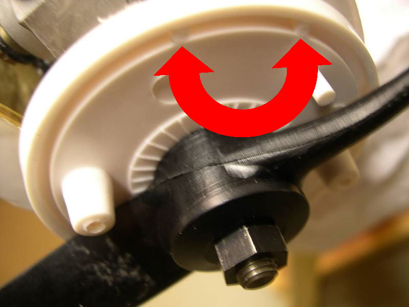

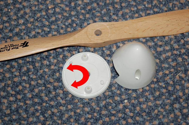

747 - Thake the prop off, place it so the TRAILING edge of the prop is resting against the small pins
(Ha ha, Ken got it wrong! )

If you're a beginner and have a problem with any spinner/prop alignment, sit back and think it over.
The most important consideration is that the prop not touch the holes it passes through on the spinner cone. Anything that presses against the prop blades can weaken those blades if what touches is strong or rigid. And it really doesn't matter much if the prop touches those tiny pins or not. It only really matters that the prop doesn't touch the opening in the cone. (see the 3rd picture below)
So look at how the spinner cone is aligned to the spinner backplate. And look at where the holes will line up. If we look at the spinner backplate that's in the original picture, if we place the spinner on that backplate so the screws hold the cone to the backplate, we see that the opening in the spinner lines up with the two bumps that the red arrows point to. So the prop is going to stick through a hole that lines up where those arrows point. With most props/spinners, we really need to test fit to see where the prop holes lines up with the backplate. Like in the last picture.
BTW, there are a number of different spinners available. But thinking it over works for all of them.
(BTW, the alignment posts on my spinner are NOT straight up. I used that spinner on a 4stroke and the engine did what 4strokes are good at doing, backfire. And the posts took the hit.)
