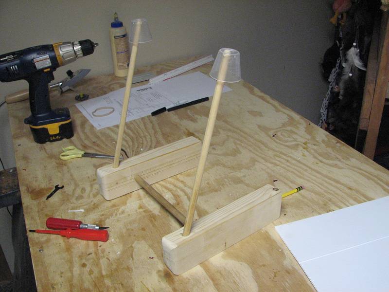

Here's my homemade CG machine, i have measuring cups over top of the dowels that way it spreads the wieght out a bit and doesn't put holes in my plane
