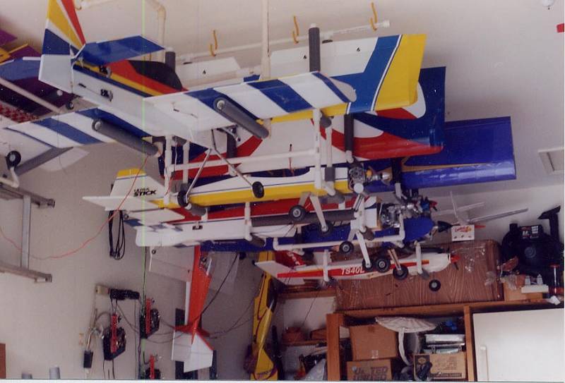

Here is my hangar. I use 1/2 in. plastic pipe and foam insulation.

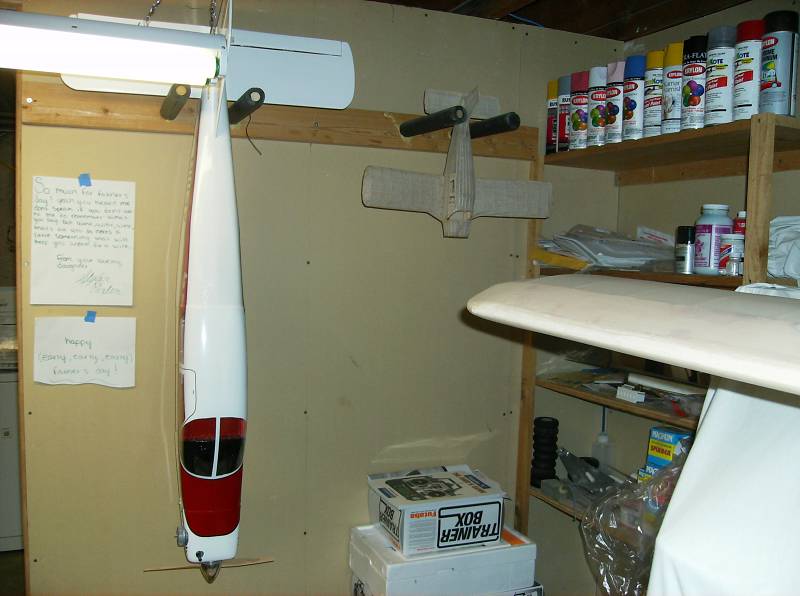

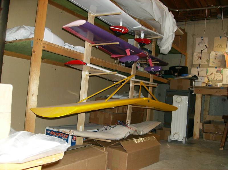

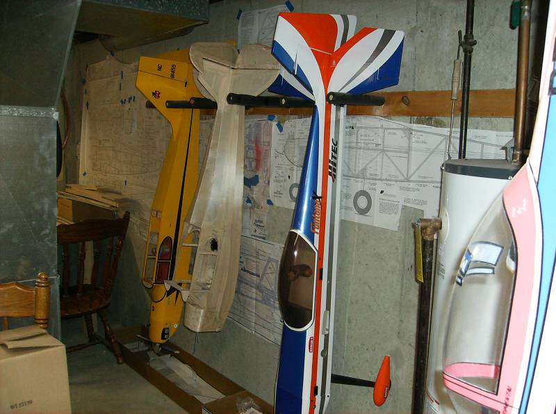

Nose Down,
Always store your planes with the nose hanging down. This keeps oil in the engines bearings. This way you never have to use after run oil either. Here is how I store my fuselages and wings of some of my planes. 2x4's and 3/4" dowels with pipe insulation for the fuselages. 1x4's and 3/4" dowels with pipe insulation for the wings.

Post #5 shows my storage area. I still put both the car and van in the garage with the car under the first 3 airplanes. During the summer I leave the vehicles out until the engines cool off or sunset that way it doesnt get too hot in the 'hangar'.
