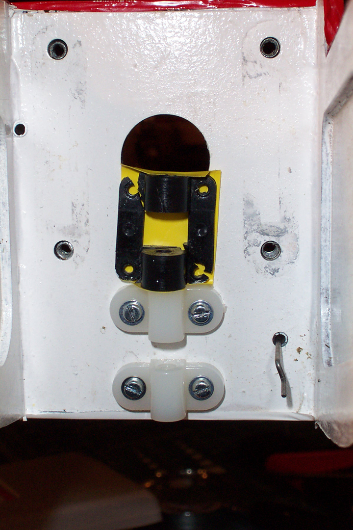

Had a little incident with my Alpha 60 and found something that other Alpha 60 pilots should be aware of. I went out Sunday for some flight testing after fixing the aileron torque rods (they where not glued in at the factory adding to a flutter problem I'm chasing), and got one good flight in (dang flutter was still there too, but that's another issue). When I started the take-off roll on the second flight, just as I started to pull up elevator, the nose gear collapsed under it. This was the take-off run for the seventh flight, it has all of 16 landings with almost all as nose high as possible on the mains, and no landings or abuse to the nose gear.
Upon examination it appears the nose wheel bracket gave way because of one simple fact - its too small for this size and weight of plane. It's so small I think its suited for a .21 sized plane. I've received some correspondence from another Alpha 60 owner who has had the same issue with his and he concluded the same thing, especially considering this an 8 pound plane that under normal training will see more than its fair share of abuse and hard landings on the nose gear. My choices right now are install an after market nose gear suitable for a .60 sized plane, or convert to a tail dragger.
This is a design flaw I found out about the hard way and wanted to pass on. If you have one of these planes, keep tabs on the NLG bracket to make sure you don't have to deal with it after the fact.

Since my plane was the RTF, here's the procedure I used to remove the engine to get access for the new NLG brackets. I picked up Dubro Cat. No. 153 Shock Absorbing Steerable Nose Gear - the complete assembly version along with 5/32" X 1-1/4" axles and 5/32" wheel collars.
* Remove the fuel tank
* Remove the muffler
* Remove the fuel line between the needle valve and carb, then the nipple on the needle valve.
* Remove the hold down bolts going through the engine and engine mount on the needle valve side.
* Mark the location of the throttle push rod at the servo, loosen the retainer on the servo arm so the throttle push rod can be removed.
* Remove the engine mount from the firewall with the engine attached to it, and allow the throttle pushrod slide out of its guide tube.
* Remove the stock NLG mount (or broken one in my case).
At this point I reinserted a factory into each factory installed blind nut and, using a small hammer, knocked the blind nut out. Next I drilled out the holes slightly to open the holes for the new Dubro blind nuts that come with the NLG to fit the firewall ( didn't pay attention to the size bit I used - you'll have to put a drill up to the blind nut to see what size is required for it to fit into the firewall and allow the teeth to bit into the wood). You may not have to do this - you may be able to reuse your factory hardware, or could try the Dubro screws to see if they fit. I personally feel the blind nuts that came with the plane are too thin walled which is one reason two of the factory screws pulled out - the Dubro hardware is much better quality.
To insert the new blind nuts I used a threaded rod to pull the nuts onto the firewall. This allowed me to screw the nuts onto the rod in the radio compartment where I had room to work, then pull the blind nut into the firewall to seat it. After all 4 blind nuts where seated in the firewall I used the Dubro brackets and screws to pull the new blind nuts tight into the firewall and used my hand to make sure the screws didn't push the blind nuts out. When installing the brackets I put the steering tiller between them to make sure it wouldn't bind. This where I left off for the night.
Tomorrow I'll remove the screws one at a time, loctite and reinsert permanently. I found the factory NLG seemed to fit the Dubro mount with very little slop, so I'll try and reuse that before I start to cut the new NLG. Yours may or may not fit - only way to find out is to try it.
The difference in the size and quality of the factory H9 bracket and the Dubro is substantial. You'll also have to cut the two plastic mold rails between the brackets as their spacing is just a bit too far apart to fit the factory holes, but width wise it fits.
When I start on the tail I'll get some pictures as I go so you'll understand what I'm doing to brace it with triangular stock.

I finished installing the NLG, and engine - that's all ready to fly. The attached picture shows the difference between the Dubro mount blocks (white) and the factory Hangar 9 mount block (black). I was able to reuse the factory NLG but had to grind a small flat below the factory ground flat so I could cant the tiller arm enough to prevent it from hitting the firewall and stopping the plane from turning left on the ground.
