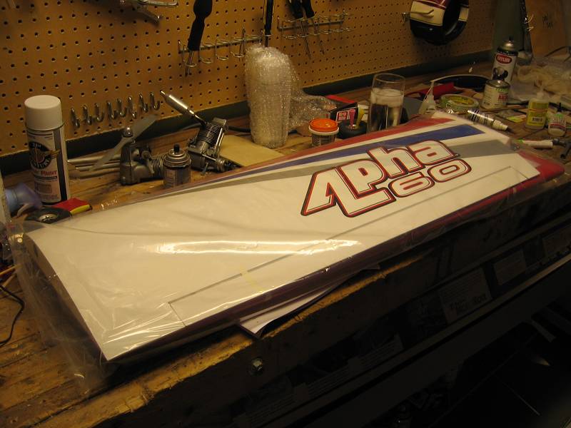

We began by opening up the very large box. As I mentioned previously, my father-in-law didn't want to open anything until he was here with me, so I got first crack at it. Everything seemed well packed, so as to avoid damage (more on that later). The ads say the plane can be ready to fly in less than an hour. We'll see.
Wanting to play by the rules, I started with the instruction book. Step 1 is assembly of the wing. Upon inspecting the wing halves, I found a typical high quality Hangar 9 UltraCote covering design. Only one problem: It was very wrinkled, more so than any other Hangar 9 ARF I have ever seen. I started out shrinking it up with a covering iron, but soon decided that was too slow and moved to a heat gun. After about 20 minutes of work, I got things looking pretty good. Boy, I'm going to have to hurry to get this done in under an hour.

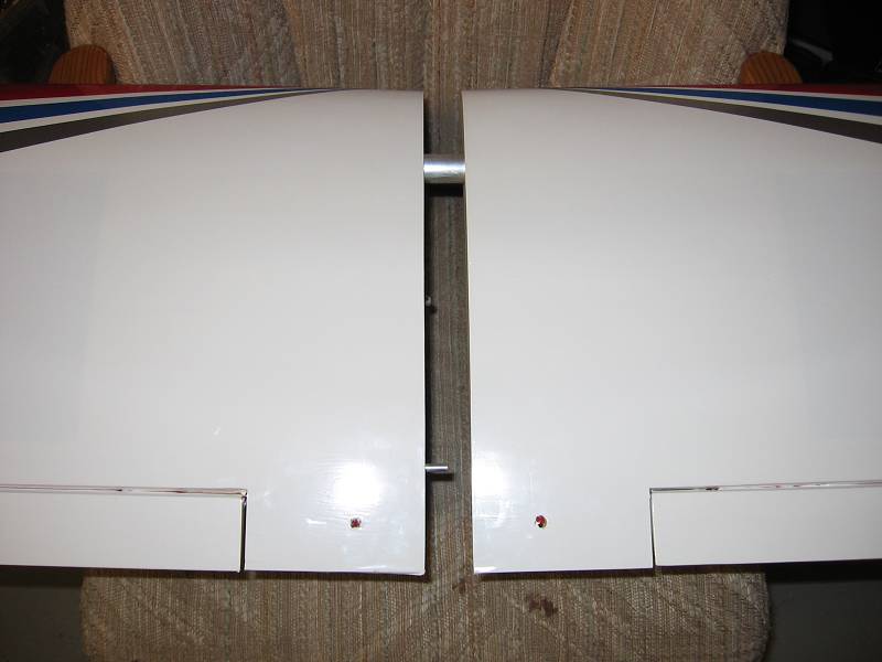

Two attachment options are provided, rubber bands or bolts. We are going with bolts. Regardless of the attachment method, the wings halves are joined in the same way. There is a large aluminum tube that fits perfectly into tubes in each half near the spar. This sets the dihedral. There is a smaller pin near the trailing edge that keeps everything in place.
The manual then instructs you to apply a narrow piece of tape to the joint to hold the wing halves together. I'm sorry, but I can't go for that. No can do. (Isn't that a song?) Even though both halves will be bolted to the fuselage, I'm not comfortable just having the wing halves taped together. Accordingly, I applied a thin layer of 30 minute epoxy to one side and slid the wing halves together. A perfect fit. As long as I had the epoxy out, I cut the covering away from the two holes in the leading edge. I chamfered the provided dowels for wing mounting and installed them in the holes. I also cut the covering away from the holes for the wing bolts.
The aileron servo was already installed in one wing half, so I connected the pushrods to the torque rods. The ailerons seem to be set pretty well without any further adjustment. I then set the wing aside to dry.

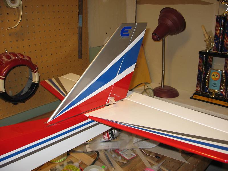

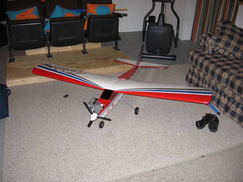

Fuselage work began with the heat gun again. Things were pretty wrinkly on the fuse as well. The next step is to install the main gear. The wheels and nose gear are pre-installed, so installation involves screwing in two screws to blind nuts in the fuse. Now it can stand on its wheels! Tail surfaces are next.
The tail surfaces didn't have as many wrinkles, but there were some dents in the balsa. The dents did not seem to come from shipment. They appeared to have been there when it was packed. Shrinking the covering covered the dents pretty well. The vertical fin has two small bolts protruding from the bottom. The horizontal stabilizer is attached to the bolts with wingnuts and thread lock. The whole assembly is then attached to the fuse with two screws.

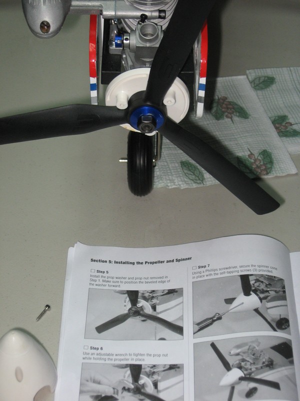

Herein lies another slight glitch. The manual states that two phillips screws are provided and that you should use a magnetic screwdriver to get them up through the fuselage to the holes. Instead of phillips screws, however, socket head screws are provided. It took a while to confirm this, and it could be confusing to a beginner. The socket head screws are easier to install. The control horns are attached to the pushrods and we are done with this step.

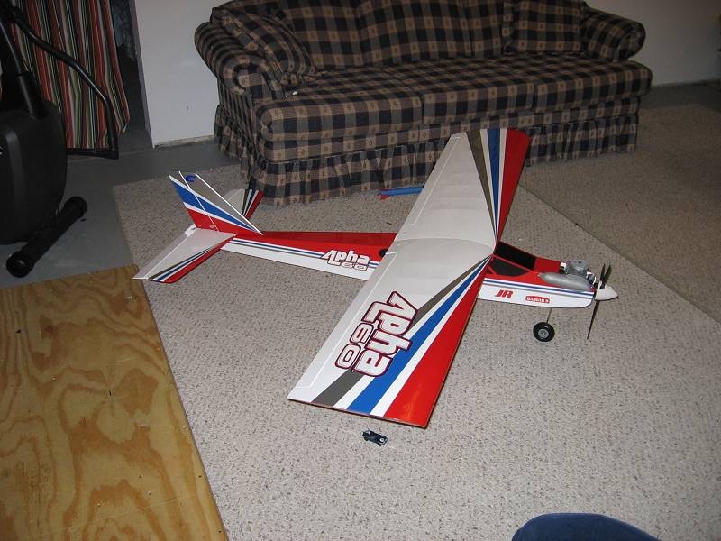

The final step is to install the three-blade prop and spinner. Now its done! By this point, the batteries have charged up enough to at least check out servo operation. Everything works well. Here's more pics:

I couldn't, however, resist taking it out and firing it up. I fueled it up. Not sure how big the tank is, but it seemed to take a lot of fuel. Primed it, put the glow on and hit it with the starter. It fired right up. I leaned out the high end to close to the max on the limiter. It seems pretty good. I'm very impressed with the way it runs so far. The flywheel helps it idle nice and slow. We'll see how it performs with the three blade prop.
I taxied it around the cul-de-sac a little bit and immediately noticed that the nose wheel was way out of line to the right when the rudder was centered. Easily solved by adjusting the pushrod at the servo.
That's it for now. BTW, total assembly time was around 2 1/2 hours. Of that, probably an hour was spent on the covering. If you didn't mess with the covering and you didn't epoxy the wings together, you could do it in about an hour.

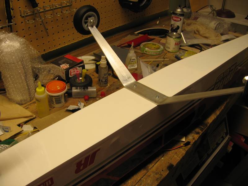

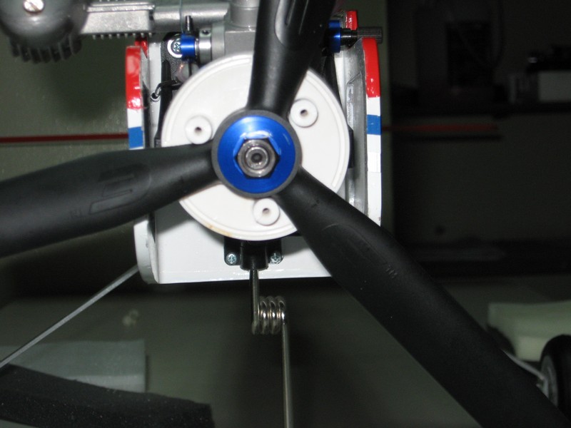

Now I have another problem. Every time I try to start the engine the bolt that holds the propeler becomes loose. The first time it happened I thought maybe I didn´t tightened it hard enough, so I did it again making sure this time it was pretty tight. Once again, as soon as I applied the starter to the cone on the propeler it got loose again, so much so that the propeller just comes off. I thought about putting a preshure washer but there is barelly any thread left for the bolt, so the washer won't fit.
Has anyone experienced something like this with your Alphas? I have added a few pics so you can see how I am fitting the propeller, that to me looks exactly as the manual indicates.

Make sure you are not trying to crank the engine in a flooded condition. Just remove the glo plug, and spin it through about 5 - 10 flips with the glo plug out. You might want to put a cloth over the hole for the plug for the first couple of spins in case it spurts out fuel. I found that it is easy to overprime the motor. Just 1 or 2 rotations after the fuel goes into the main needle is all it should take to prime it.
It hasn't happened with my Alphas, but has with other planes. One thing that sometimes works is to make a washer out of sandpaper the diameter of the prop hub. Put it between the back of the spinner and the thrust washer of the engine. Not sure what you are using to tighten the nut with, but you should use a good size crescent wrench or box-end wrench. The 4 way glow plug wrench won't apply enough leverage.

- Yes, the engine can kick and throw the prop. It's fairly common, and usually due to over priming as mentioned above. The limiter in the needle might play a part here because it's often a bit rich and allows more fuel in to the engine than you need to start. The engines are run once, but not "broken in" when you get them. As you get a few hours on the engine, the compression will drop a hair, and this tendancy will go down quite a bit. Once in a while we get one at the field that's really tight. That's great, it's going to be a bit more powerful than average, but it's also going to toss more props than average as well when new. It also helps to be "agressive" with the electric starter. Guys who are afraid of applying pressure with the starter throw more props because the starter isn't getting enough grip to push the engine through compression fast enough, and the engine backfires. Working on your starter technique will reduce thrown props a lot.
- Do yourself a favor and remove the bolts that hold on the nose strut one at a time, and put on some locktite. It's not a question of "IF" they will fall out and leave you with a dangling nose wheel, it's only a question of "when". I must have seen this happen 4-5 times on different Alpha 60s

- I agree that glueing the wing halves together is the way to go, however most of the 60's at my field were put together guy newbies following the directions, and I've never seen a problem with the tape, even with guys who opted for the rubber bands. It really does work, even if I'd still do epoxy myself

After reading the posts above I decided that maybe I just wasn´t tightening the bold hard enough, so I pulled the motor out of it's support, got a good confortable hold of that sucker and applying leverage with a good wrench little by little the bolt went farther in. It went in smooth and felt real solid and finally the thread on the shaft came out the bolt.
I put everything back in place and finally was able to crank it up. I was gladly surprised by two things, first it fired up as soon as I applied the starter and went into a low steady "purrr" at low idle, and secondly I couldn't believe how quite that Evolution engine is. At idle you can just have a normal conversation confortably right next to the plane and even at full throtlle is not ofending at all like other planes some of my buddies have at the club that are just annoying when they are setting them up on the ground.
