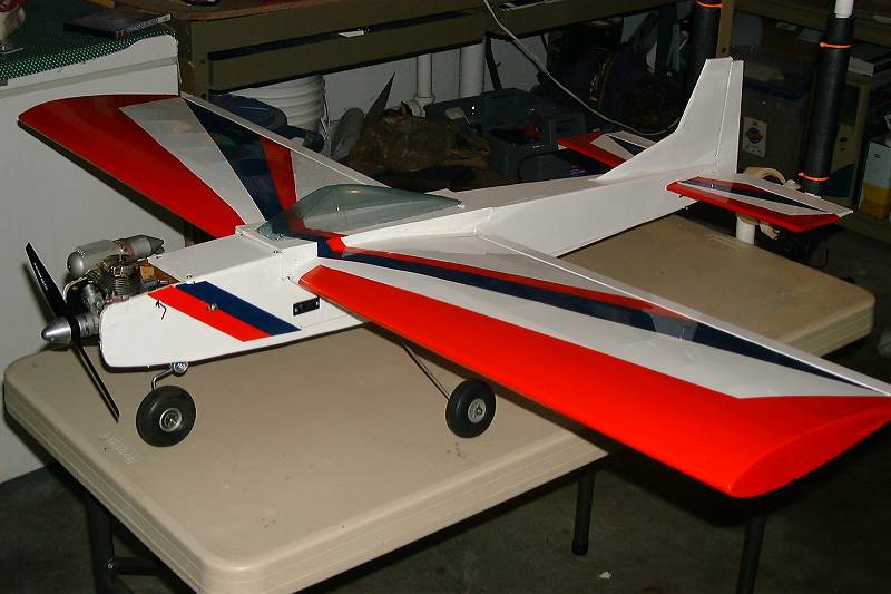

Thanks to everyone for their help. I used just about everything suggested plus some goo removal stuff purchased at the hardware store. Here is the finished result. The wing was already covered in white;I added the stripping.

Old 09-25-2007 | 07:07 AM

Old 09-25-2007 | 11:46 AM

Old 09-25-2007 | 06:16 PM

looks like everything turned out good.i like the stripes.

Thank you. The stripes are straighter in real life as than they are shown in the picture.
