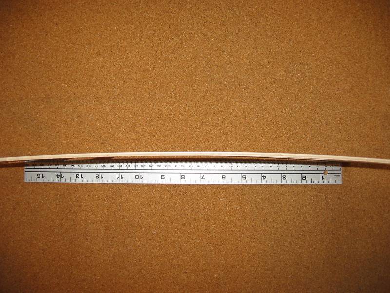

I just finished doing all the inventory on a new GP Extra kit. I separated all the parts into large ziplock bags to have it all organized and labeled each of the zillion sticks that come with the kit. Some parts are slightly warped which do not concern me, but the front top part of the fuse is more more less considerably warped. How can I determine if the warp will affect my final product once the piece is fitted and glued with the rest? If so, what is the best method to un-warp a ply or balsa piece?

Determining if a warped piece is usable or not is a matter of judgment on how badly warped it is, how much pressure it takes to straighten it out, and where it's going to be located. If you are concerned about, replace it. Better off with a new piece than a fuselage that warps after it's finished.
The thicker the material the more likely it is to go back to the warped shape due to internal stresses. Thin sheet it OK to use since it doesn't take much pressure to overcome the warp, but thicker blocks may need to be planed/jointed or recut to true them up. Also if it’s a piece that will be carved, the it may be OK to use it since you’ll thin it out and could remove some the warp inducing internal stress.

Maybe some images might help.

try and remove the warp... you can try to wet the inside of the warp and lay some weight on it till dry

I did. I actually soaked the whole piece and pressed it with 3 10lb bricks and let it dry overnight. Nothing changed.
BTW, what do you think about the corked building surface? Is it a good idea?

Actually, for plywood, that's not bad. You usually must bend the piece a little in the opposite direction after wetting it. Using a little vineger instead of water, that will help, too.
That fuselage is built up of plywood pieces. That piece is warped along the length. If the rest of the pieces are fairly straight, I wouldn't worry about it. They will pull the top into alignment.

So this amount of warp is not that bad, great. I recon from what I can see in the plans, that it might actually not be bad at all since it lines up with the main fuse sides perpendicularly so it will be forced to sit straight.

I wouldn't hesitate to use those pieces. It's the nature of wood to warp when the moisture content changes. As long as you glue it straight and hold it that way until it dries, you should be fine.

I wouldn't worry too much about it , if that's the actually piece in the photo that's in question.
You build with that piecce flat and pin or tac your building surface anyways.
have the fire wall hang beyound the table slightly
The sides and the formers will keep it nice and boxie. just glue it striagth and use a triangle to check it.

Yea, as others have said, the rest of the plane will straighten that out. That is very typical for a plywood piece. Don't sweat it
