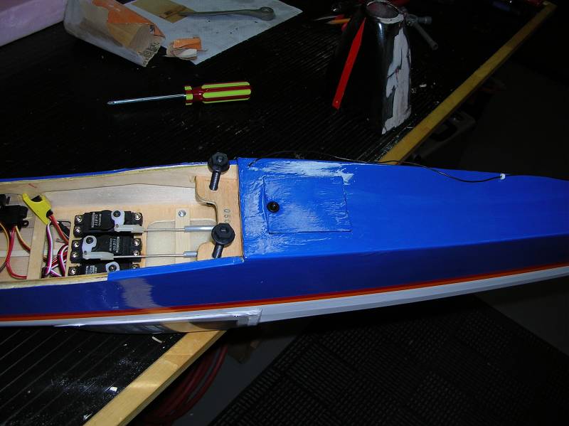

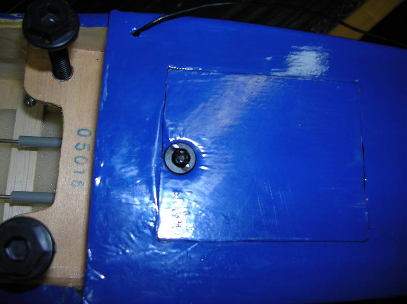

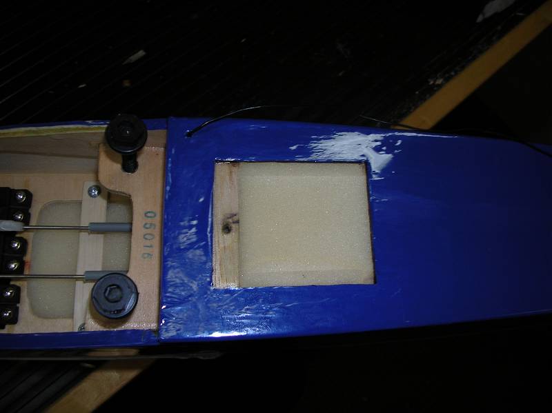

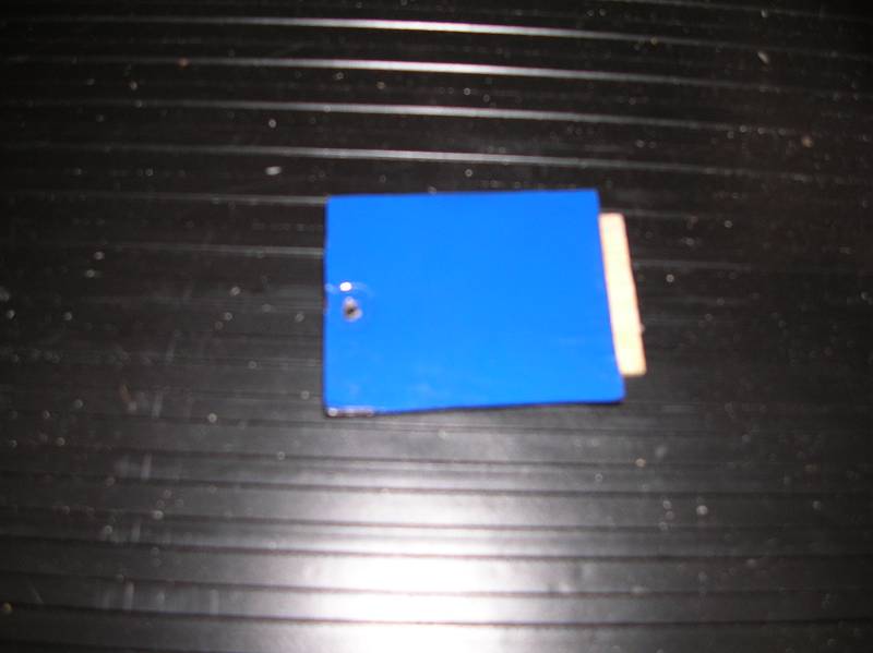

Old 10-14-2007 | 02:25 PM
Joined: Jun 2006
Posts: 1,407
From: granby, QC, CANADA
Default RE: Extra Tail Weight - where & how?
would you be able to add a battery hatch behind the cg?
This is one my dad built for a great planes super sportster
this would allow you to not have to add anything.
Steven

Old 10-16-2007 | 06:43 AM
My Feedback: (8)
Joined: Sep 2003
Posts: 1,917
I'll have to work these in on the next plane.
