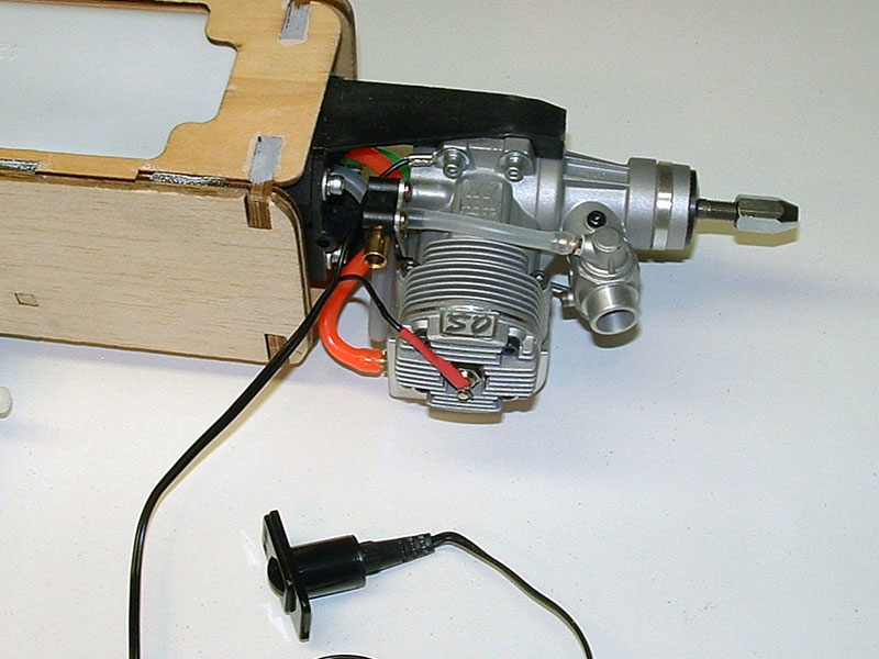

Yes, it's a great engine. I had a few that ran great on 15% Cool Power. As mentioned, use an OS "F" Plug.
As Flying Freak noted, the pushrods in the rear get good protection in case of a crash. But the bad news is, this slants the glow plug forward and very near the prop.
Be VERY careful when removing the glow igniter! In fact, you might really want to consider a DuBro Remote Glow Igniter pictured here:

Mike I am going to install the remote igniter as you suggested. Thanks Philip

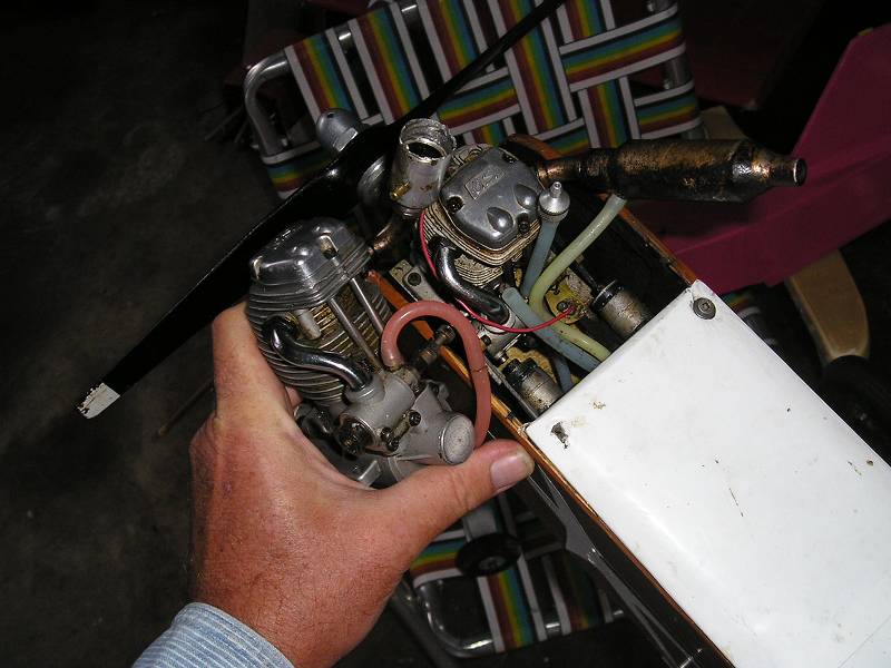

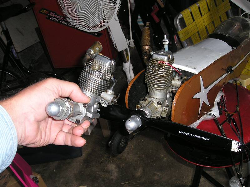

Hello; I have that engine in my 4 star 60, I use a MAS 14 x 6 and use little alligator clips for the gloew driver, great combination.
I tried a Saito 80 but I had to add weight to it to balance, the FS90 balanced it off perfectly. Now I have had to do a few repairs and have added some weight to the front to balance my repairs.
