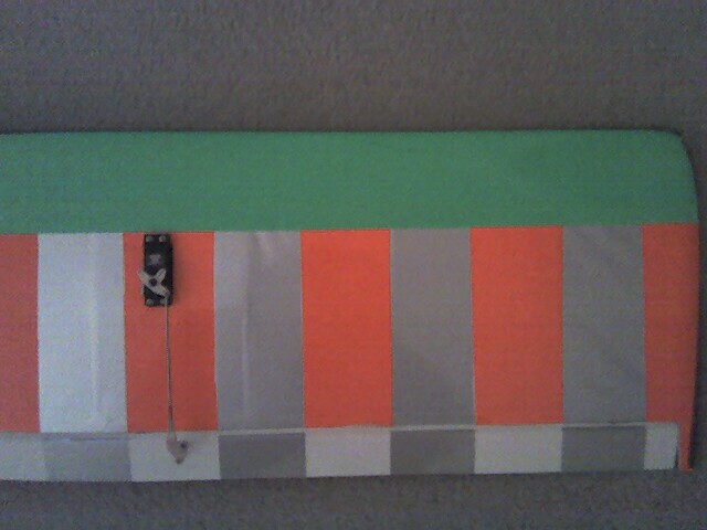

Are planes harder to see when its cloudy out?What color or combination of colors are good for under the wings, My plane is white and it is hard to see when its cloudy out.

Yellow or orange is probably the easiest to see. I generally cover my wings in yellow and I will add red stripes about 3 inches wide or so, diagonally on the top wing. This gives good visibility and I can easily see whether the plane is upright or inverted.

Default RE: COLOR FOR VISABILITY
Yea, white, Grey or light blue are the worst
It's not so much "what color" as "what "Combination of colors" is what's important.
A red or black airplane can be seen easier than a white airplane, but they can get lost among dark backgrounds.
The best combination is light and dark colors with bold patterns.
Personally, I like white airplanes with red wingtips. Beyond that, the designs are up to you.

Old 10-17-2007 | 08:14 PM
dragnbye's Avatar
Joined: May 2007
Posts: 324
From: willoughby, OH
here is my wing this is on a pulse it a small plane and still be hard to see. i my lose the plane but the green just pops
