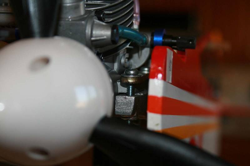

OK, I finally pulled my Easy 2 down from the closet where it has been collecting dust for about 2 years.
Just playing around with it, I noticed that the installed engine mount seems to have a very pronounced downward slant towards the nose of the aircraft. It looks like 10 - 15 degrees off horizontal.
I've built kits before, but I don't remember any of the motor mounts I used having a downward slant
Any thoughts?

Some downthrust isn't unheard of but that seems excessive. I suspect that living in a Fla attic for so long may have softened the glue on the firewall and the weight of the engine may have caused it to droop. See if you can detect that the firewall has shifted.

I had an easy 2 trainer and it NEEDED the dramatic downthrust to fly good. I bet it had at least 7-10 degrees downthrust. I would try it with that.... inspect all the joints and hardware. make sure nothing has moved. If it has not, then I would go for it.

I was just guesstimating on the angle. Here's a couple of pictures. The first shows the angle of the prop shaft and the second shows the cylinder head in relation to the "cowl" The forward bulkhead looks secure and square in relation to the fuselage sides.
Hope this helps.

Yep. That looks very similar to mine with regard to the angle.

I'm hanging a OS Max .46 on the nose. The motor mount is the "clamp down" type. When I put the motor on the rails, it doesn't look like there's a whole lot of of engine mount sitting on those rails. Maybe like 1/4" or so.

Here are a couple of comparison pics. Sounds like you have the same type of mount I do. I've got the Evolution .46 in it. It might be hard to see in the picture, but I have about the same amount of motor sitting on the mount. Only about half of the mount is covered on each side. so, either both our planes are screwed up, or everything is fine.
Hope that helps!

Motor tilt not as bad as you made it sound at first. And that is typical for clamp mounting of engines.
