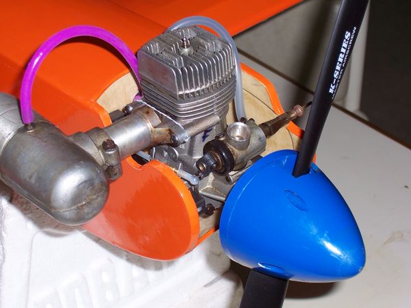

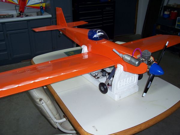

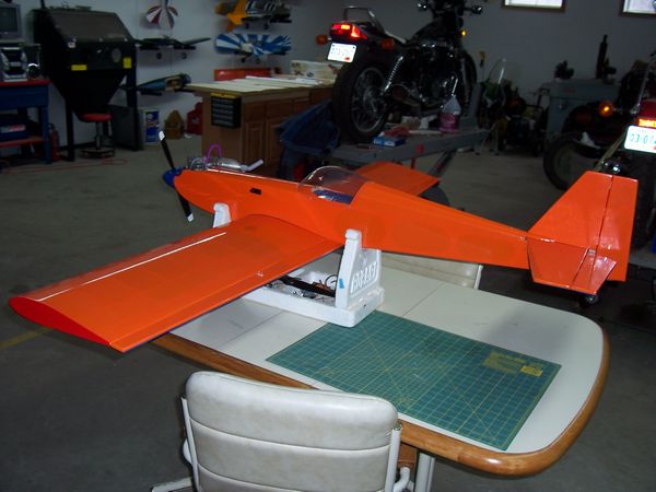

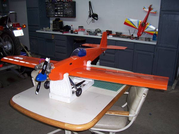

Just finished my 4* , Need to trim the canopy and decide on what kind of stiping I`m going with.
Has an old SuperTiger G90 that I put a new ring , sleeve and bearings in. Runs really nice.

Looks really nice. You will have a blast flying it. I noticed in the picture that shows a close up of the engine that the engine compartment does not look like it was fuel proofed. If not, you can just just expoy glue thinnned a little, but it does need something or the raw wood will absorb the fuel.
I have just finished covering the fuselage of mine (#4) and hope to get the wings covered in the next couple of weeks.
Again, good job.
Old 12-27-2007 | 12:59 PM
Insanemoondoggie's Avatar
Joined: Nov 2006
Posts: 2,475
From: Altamont, MO
Default RE: Engine for my Four Star 60 Kit.
It is fuel proofed with 30 min epoxy , at the firewall and fuel tank area. And the wing area has flat clear lustre coat applied .
