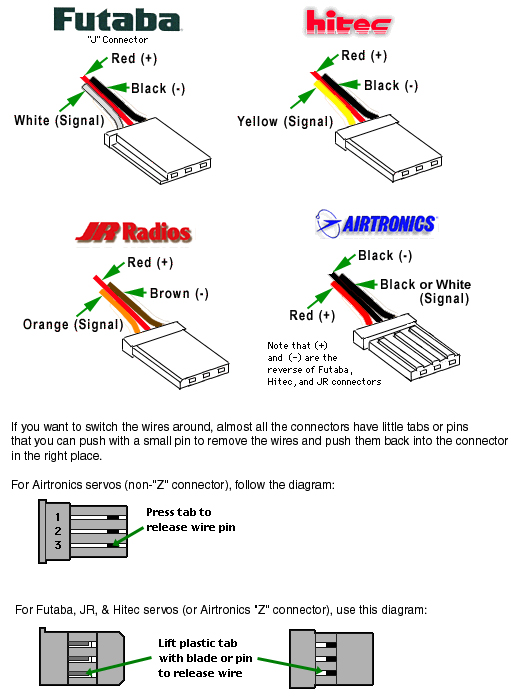

Ok, you Airtronics Guru's out there.. a little help please!
I have an Airtroncs Quasar 6 channel radio, on FM channel 15.
Is this system compatible with the current Airtronics servos (or any other for that matter)? I have 5 94102'a in the box but they have a white signal wire where the newer ones have a blue signal wire. I seem to recall reading that there was a change in the compatibility of these servos from the original Quasar to the more modern RD's or whatever.. servos.
Is this radio compatible for use today (narrow band or whatever..)?
CGr.

CGretired,
The answers are yes and yes. You can use servos from today, but you will need to change the wires on them. Simply switch the positive and negative wires. And yes, the radio is compliant with narrow band standards. I have 2 of these radios and I love them. They are rock solid and very reliable. You won't have any problems with it.
Ken
