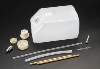

Few more questions. Can I bend these brass lines well enough with pliers? What is a fuel tubing bender, nailset and center punch? Where do you get those things?

It would be tough to bend that much of an angle with pliers without kinking it, but it can be done.
Here is a tubing bender, I have been told it works great.

I got one for all of you guys. Instead of buying a tube bender just get the right size weed wacker line and put it in the tube before bending. It stops the tubing from kinking. I usually do all my bends with my hands, its only light brass.

Does anyone know if those brass fuel tubes have to be bought at a hobby shop? Can you get those things at Lowes or Home Depot?
I'm tempted to try it as is, although better safe than sorry is probably the best policy here.

Another trick to bending tubing is to fill the tubing with sand, sugar, or other non-compressible powder. Then just let it run out after you bend the tubing.

If you have to keep it that short there are three clamping methods
1. cut a Short piece of hose, expand it with a set of forceps or small needle nose pliers and slide the fuel line in that piece then put it back on the tank.
2. use a small cable tie on them and pull them as tight as you can to clamp the tubing on the nipples.
3. wrap a piece of single strand wire around it and twist the wire tight but not tight enough to cut the hose (this take practice)
any of those work well, I have done a few planes where the plug and tank nipple have extended through the fire wall and not had a lot of room. Like putting a 120 in a 60 size war bird, 100 on a magic extra, etc.

you can try hardware stores for the brass tubing.
but as it is i don't really that big of a problem with it.
Just make sure the tubing you have don't come off..use culking glue or what have ya.
you're not going the want the tank to be sitting up against the fire wall anyways
not sure if you're planing on wraping the tank with foam...I do. That pading
is going to move tank further back so the tubbing is not going to kink.
Leave it long and slice it back a little bit at a time.
plus I think you're going to want to move the tank back as far as you can
having a heavier engine on the nose. it's not as if you're going to move it back a foot.lol
you should have extra fuel tubbing laying around anyways
I don't know...a couple pair of needle nose pliers are nice to have. that's what
i use for tight spots. A .40 is going to give me what ?...a hair more worth of room.
you can always use a different size prop or pitch..if you think the engine has too much power.
it's just fuel comsumptions that's all.lol yeah wake up the left thumb.
