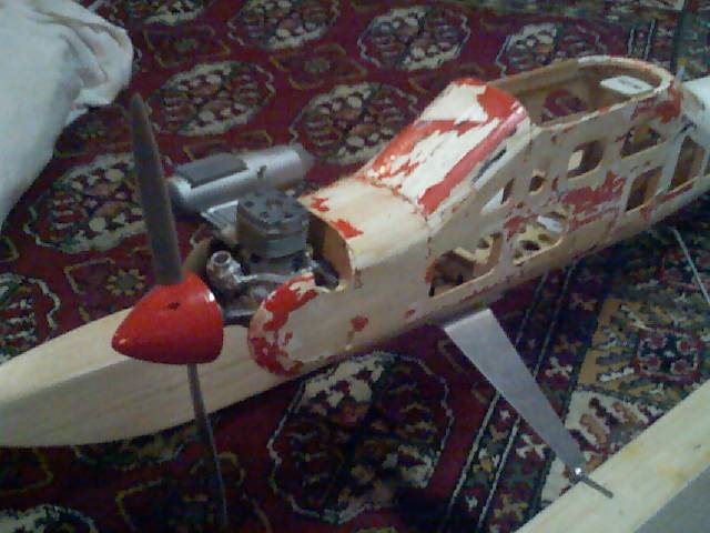

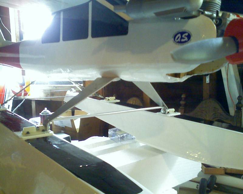

eventually I ended up stripping the covering repairing some broken areas and converting it to a float plane,for redoing the windows the peel and stick black covering works well you just need to make sure the surface your sticking it too is super clean any grease or exess fuel and the stuff comes off.
