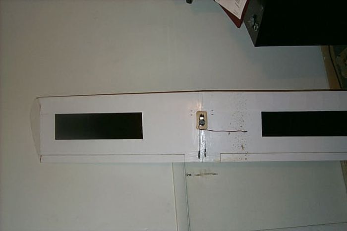

I've got a "near retirement" LT40... flies well with an OS 46FX. The bright contrasting strips on the wings is a good idea.. I put fluorescent pink on my leading edges... looks ugly, but it sure shows up against those grey west coast skies!
