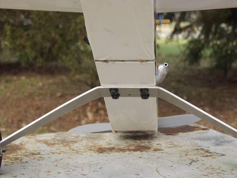

I have flown and crashed both. I like the 4* better because of the aluminum landing gear. Didn't like the stick gear on Dolphin, it bends to easily. Other than that they are about equal. both fly the same.

I was concerned about the landing gear on the Phoenix too. Was looking at the Great Planes Super Sportster 40 Mk11 and although good comments, there were concerns about its flimsy l/g too. Suggestions offered were to add a stronger l/g, like rleon has stated.
Therefore, wondering if the Phoenix could have a stronger aluminium l/g added. Would this affect the CofG much?.

If you can find an aluminum landing gear you like, it can be installed on the Phoenix Dolphin with a minimum of trouble.
I use a 1/4" maple doubler on the inside with bass wood triangle stock on the ends of the doubler. If the fuselage bottom is not hardwood where the gear fastens, cheek plate it with some thin maple plywood.
I like to retain the gear with the plastic 1/4-20 wing bolts. I use four of them and they are threaded right into the bare plywood. I put thin CA over the threads and retap. The gear will break the bolts and shear off without damaging the bottom of the model.

the landing gear holds up pretty good (as good as the ones on my H9 arrow),I had to remove and rebend em once on the first one, haven't had to rebend the second ones yet. (I have seen aluminum ones have to be rebent too)

The Dolphin is a great flier. It was my second plane and is very stable. Lands beautifully. Still pretty aerobatic and strong with a 46 engine. I did change the landing gear out to Dubro pretty soon after flying it for the first time. A flying buddy still has it as a favorite. They are built well and really no different than a 4* except for price. You would not be disappointed with it.

Although the Four * is regarded by many as the perfect 2nd project, the comments made so far have cemented my faith in the Dolphin. Adding a more solid landing gear is not a major hurdle, which I'm sure, will ultimately give me confidence and experience to progress further in this great hobby. Thanks to all.
