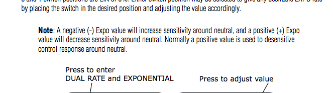

ORIGINAL: CGRetired
If you are a novice, still learning (like anything within a year of solo is still somewhat novice), then you need not worry about dual rates yet. A good negative exponent is much more effective than playing around with dual rates.
Set the plane up for no more than what the manufacturer recommends for soft action.. usually what they want for maiden flights. Then add about 30 % negative exponent and fly it. It will seem soft for minor inputs, but responsive for harder inputs.
If you are more experienced, well, keep the exponent and just dial in a bit more throw in the control surfaces. Once you master the elements with this sort of setting, then consider adding some of the dual rates recommended, but be careful not to add to much at first. It will scare the heck ouit of you. Those .5 second rolls will drive you nuts!!!
CGr
At doing what making the plane twitchy at center stick?
until he comes back with a reply i beleive he ment to advise you to add POSITIVE
Steven
Old 01-03-2008 | 10:04 PM
Joined: Feb 2006
Posts: 4,465
From: Arroyo Grande, CA
Default RE: HIGH RATES LOW RATES
Steven, negitive is correct. Positive gives more movement near the center which would give you your twitch sticks.
Don
Old 01-03-2008 | 10:35 PM
Joined: Jun 2006
Posts: 1,407
From: granby, QC, CANADA
ORIGINAL: Campgems
Don
Page 47 of the manual (and no i don't have a dx7 ...)
Steven

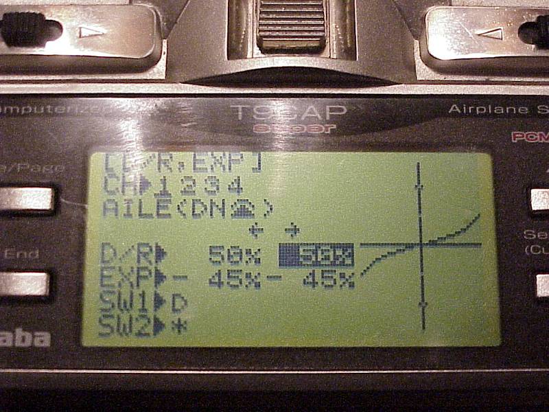

Steve, the Futaba is the reverse. I based my comment on that and I'm sure CGr was refering to the Futaba also. It's good to know that all radios don't use the same references. I could have caused someone quite a bit of trouble by assuming that they were all the same.
Live and learn.
Don
ORIGINAL: Flying freak
ORIGINAL: Campgems
Don
Steven

I'm not arguing with the fact that futaba is oposit just this guy stated he had a spectrum radio in his opening post and telling him to put an expo percentage that would make things touchier i think we can both agree would NOT be a good thing..
-Just if nothing else i think we should use this as a wake up call to be slightly more careful even more so in the beginner forum because it could have had a bad outcome... i m guilty of it also and im happy i have been corrected in the past because bad advice (not intentional of course..) in this forum could be devastating to a new commer.
Steven
