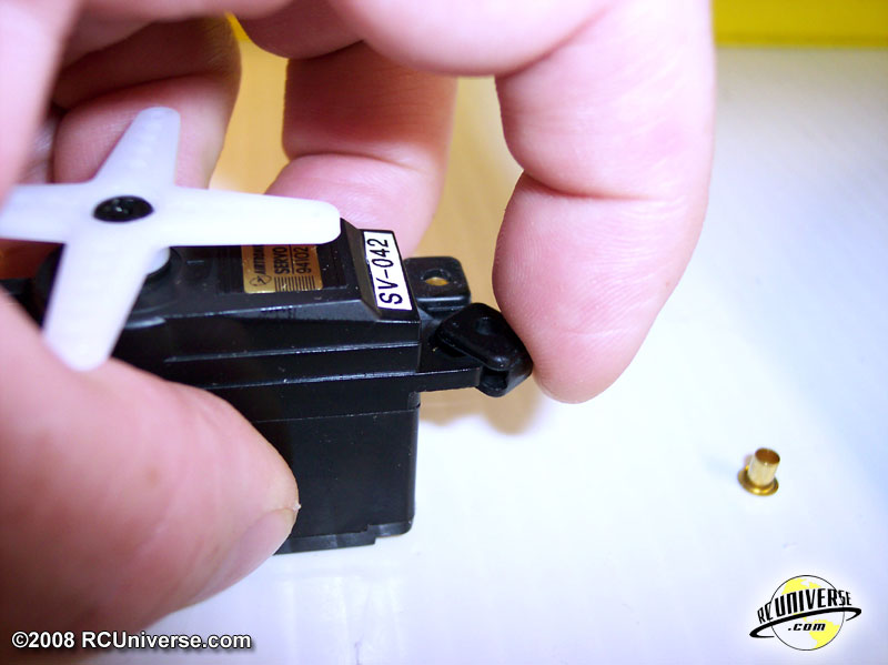

I have never built a model and am beginning the install of servos in a Hobbico Superstar.
The instructions for the Superstar say to install the servos according to the servo mfg. instruction?
The servos came in the box with the Airtronics transmitter radio and all they say is install the "rubber grommets and hollow eyelets to the servo.
They dont seem to fit no matter how I try.
Anyone shed some insight on where the rubber grommets go???
Thanks for the help!
Wayne

I just re-read your post and saw that you have troubles with the servos is with the rubber grommets. I am sorry that I missed that. I took some pictures to help you out here.
If you look at the rubber grommet you will see that one side of it has a small "flap" over the groove in the middle of the grommet. This goes to the outside of the mounting lug on the servo case. It helps if you put it on at a bit of an angle (see the pictures) at first, then when the center hole portion of the rubber grommet is in the center of the mounting lug rotate the grommet to finish putting it on, with the little "flap" over the outside of the mounting lug. And then put the brass grommet in from the bottem as I described earlier.
Please let me know these pictures clear it up for you. If not I'll shoot some more for you.
Ken

RCKen,
Thank you very much for the fast and wonderfully clear install information-you should write the manual for Airtronics!
I figured that they grommes had to go there but when the mfg. made them, the grooves were only cut in 2 sides at a 90 degree angle and was impossible to install. After seeing your info, I found that the rubber from the 3rd side was not removed and after doing so it works great. I would have not got the eyelet in correctly without your photos.
I can now finish my model this weekend and ge it in the air.
Thanks again for the terrific help,
Best regards,
Wayne
