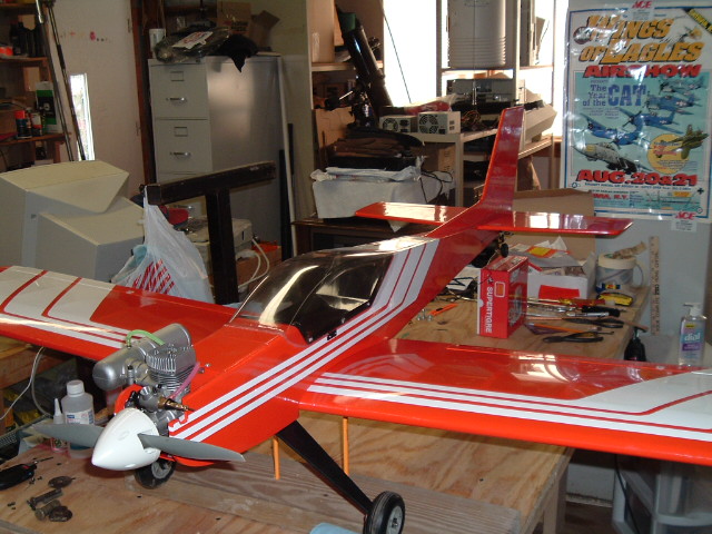

Here's mine, and in action. (I know you are supposed to balance them upside down, this is just for illustration).

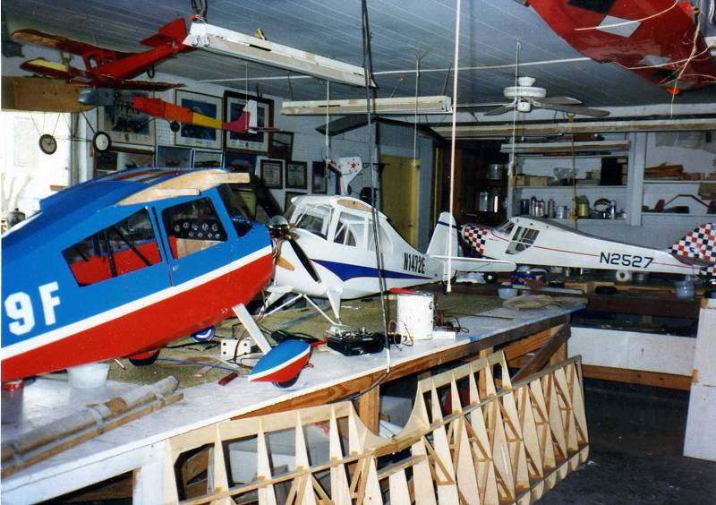

Everone has a different answer. Here is picture of balanceing plane, and my work shop.

Nice looking plane, Bingo Field
