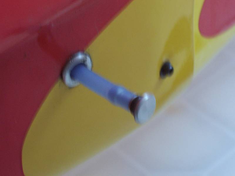

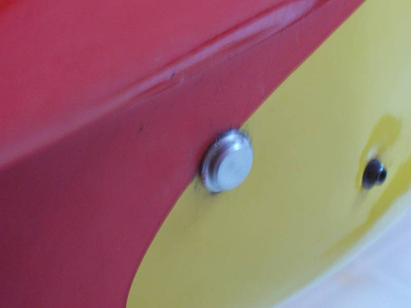

Old 01-27-2008 | 01:29 PM
Missileman's Avatar
Joined: Feb 2006
Posts: 3,204
From: Poland, OH
Default RE: .46 engine
ORIGINAL: Fflier9
How does the fuel dot system work? What are all the nozzles for.?
Use a "T" fitting on your line to your carburator or a 3rd line to your tank, 3rd line is the better choice.
Here are some pics of the fuel dot on my Showtime.
Pull the dot out which is attached to the extra fuel line, remove the dot, fuel, plug the dot back in, push it back in place and fly.
