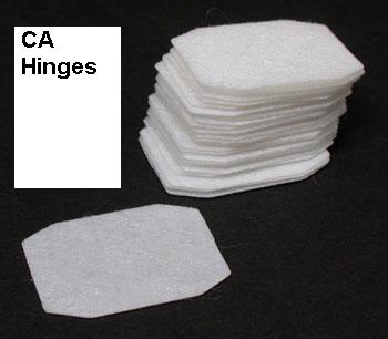

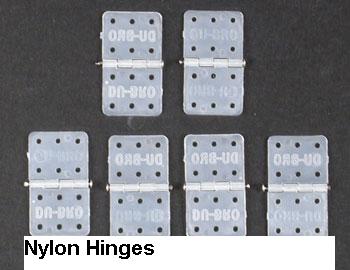

carrellh's Avatar
Joined: Mar 2003
Posts: 6,544
From: Garland, TX
Default RE: Nylon Hinges/ Epoxy Question
ORIGINAL: Seb23
I have the little white hinges, plastic i dont know if there CA hinges like u'se call them .. but should i use epoxy 30 or Ca ?
Here are a few pictures of hinges. There are more varieties but these are common flat CA and Nylon hinges.
If you use CA hinges, do not use epoxy. Use only THIN CA on them.
