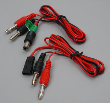

First of all, you can use just about any servos with the DX7 DC7000 receiver. And you can use just about any 4.8 - 6 volt battery you like with the RX. And, yes, you can trim the tabs off of the Futaba servo leads and use them. I use Airtronics, Futaba, Hitec, and of course, Spektrum (JR) servos with mine.
The TX battery is the one with the reversed polarity plugs. I remove the battery from my DX7 TX and charge it outside the TX with my field charger. I made up a simple charge cord using the ones you can get from Tower Hobbies (Hobbico Charger Leads) with the banana plugs on one side and the RX plug on the other side, then pull off the covering from the plug. That leaves the pins from the plug exposed. I just plug them into the TX battery, Red to red and black to black and let it go from there. If you leave the battery in the TX, you can charge it overnight using the wall wart charger.

1. yes, take a hobby knife and cut the tabs off.
2. no the plane, receiver battery, are all the same. Only the transmitter battery is reversed on JR radios (not sure about DX7 but I "assume" it is reveresed like other JR transmitters)

I have a Futaba TX charge cable with banana plugs on the other end. I use that cable to charge both my Futaba 9C and my DX7, it will fit both. Since the DX7 has reverse polarity, I just swap the red & black banana plugs at the charger. The chargers I have show the battery voltage, and will not allow me to charge if I have reverse polarity, so I don't worry about forgetting to swap them.

Yeah.. I guess that's the engineer in me.. red to red.. and so on. But, you're absolutely right. It just doesn't matter as long as the polarity to the battery is right.

I do the same thing, I just swap the banana plugs on my AccuCycle Elite when I charge my DX7
KISS method.

Thanks for the response guys. I think i'll make up one for the transmitter and put a tag on it, so I don't get the wrong one. Eventually i'll use the DX7 for any airplanes I get once i'm done with the trainer.
