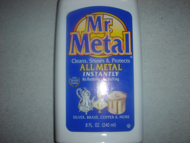

Old 02-10-2008 | 10:22 PM
My Feedback: (494)
Joined: May 2004
Posts: 1,437
From: Palm Bay, FL
Default RE: Engine cleaning
Antifreeze is pretty drastic to me. I use this to keep engines I own clean without worrying about fumes or danger to pets.
It's important to inspect the inside of a stored engine for contamination/rust.
