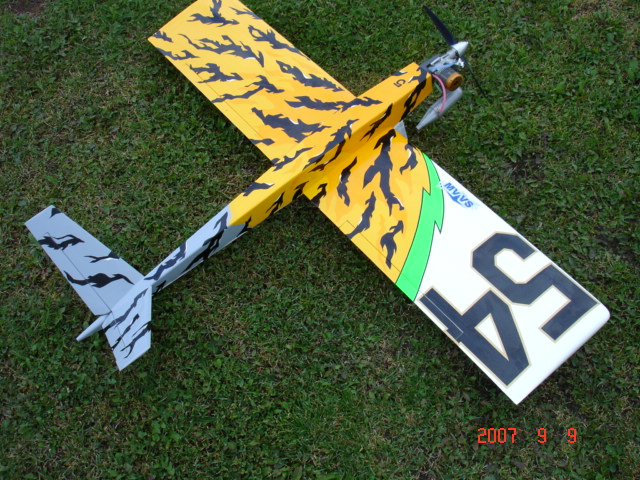

Hi!
I only use Ca glue (Flash, medium and thin) and accelerator , ocationaly 12min epoxy for joining foam wings. Very seldom aliphatic glue.
