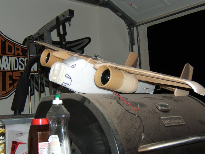

I attempted to fly the A-10, with no success. I had it about 15 ft in the air and it was nearly uncontrollable it was way to slow. it lost lift and slammed into the ground breaking the fuselodge in half tearing the wing mounts and knocking off a motor...so I decided to take an old super cub fuselodge and some CA and have some fun. I'll say this, it flys just as good as the A-10

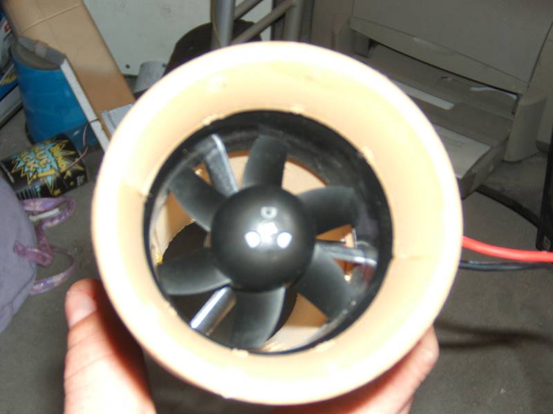

ask and you shall receive... first remove the small screw that holds the impeller on. next use a set of pliers to grip the impeller at the base, as close to the motor as possible. pull the impeller off the shaft. that will expose the two screws that hold the motor on the mount. remove the screws and wallah the motor will push out. here are some picks of the process. you can do this with the motor housing on the plane

your bad, your bad. People that don't visit RCU miss alot. Thanks for the infor and pics. I think I can handle that. Going to put a set of part 370 brushless inrunners on if I can. Thanks lots.
