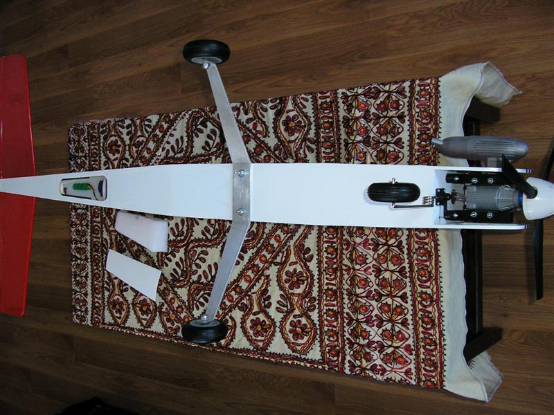

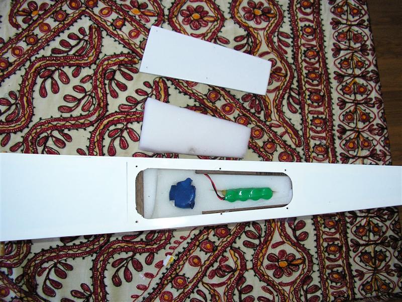

Thanks for all the tips. I got my plane balanced now and this is what I did.
I made an access panel on the underside of the fuslarge about 10 inches from the back . I placed my Battery in the access panel compartment and packed foam around it. That was not enough weight so I added 2oz lead weight in the compartment and she balanced perfect! Very slight nose down. The panel door is secured with 6 screws and I reinforce where I screw into the Bulsa with cherry hardwood. I painted the access panel and it look very neat and tidy. You cant see it unless you turn the plane upside down. And I have very easy access to add or remove the lead and battery.

can you show us some pics pete?

here is some pics

Old 02-22-2008 | 09:49 PM
Missileman's Avatar
Joined: Feb 2006
Posts: 3,204
From: Poland, OH
Default RE: Alpha 60 CG HELP!!!! I need 4oz in tail.
Looks good.
For future refference the farther away from the CG you put weight the less weight you will need.
It looks like you put the weight in front of the battery. If you had put it behind the battery you may have only needed 1-1/2 oz. All the way back to the end of the tail and maybe less than 1 oz.

hey nice job on your door in the rear of your plane ive been working on a alpha 60 the past month and im getting ready to install the engine fx 61 so i might have the same problem was wondering what you made your door from and how you cut it out on the plane also what engine did you choose? thanks for your time joe
Old 02-22-2008 | 11:57 PM
yukonpete's Avatar
Joined: Jan 2008
Posts: 212
From: WHITEHORSE, YUKON, CANADA
Engine is the Evalution .61
For the access panel I just cut the covering with a hobby knife. The cover panel is made from Basswood. Its a little stronger then Bulsa. Its about 1/16 thick. I also used cherry hardwood strips and CA them into place to give the screws more to bite into.
I went to Walmart and in the craft area they sold 12" x 12" X 2" foam for $1.97 and cut that for packing.
