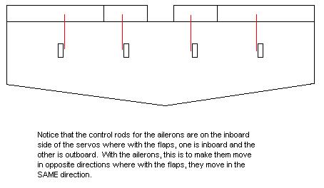

Hi,
I build a Cessna 182 and have the throtle to throthle, rudder to rudder. elevator to elevator, alerion to alerionn with y connector, left flap to gear, right flap to aux 1
I think I programmed radio wrong because everything works but the flaps.
Thanks for the help,
Zig

One of the main things I seem to find with the DX7 is actually saving the results of your changes. Go back in and re-do everything according to the book then make sure you save your changes the way the DX7 manual says to.
In the case of all the regular input channels, throttle, rudder, elevators, ailerons, and with the ailerons you are using a Y cord, you should not need to do anything to those except perhaps expo and end points. With the flaps, you may not have saved it after doing the changes. As I said, re-check that, and make sure you save everything then see if it works as advertized.
And, remember to make sure that the flap connections are on the same side (ailerons are one inboard and one outboard on the serovs where flaps, one is inboard and the other is outboard). See the drawing. Different aileron settings will have them both either inboard or both outboard depending on your situation and how your servos are installed) where the flaps left may be inboard with right outboard, or vice versa, again depending on how you mount your servos.
The drawing is just an illustration to show the difference.. again.. it depends on how you mount your servos and the direction they rotate when activated.

Well, no, you can use a Y connector for the ailerons too. So, you can feed your ailerons to the aileron channel using a Y cable to the two servos, and the AUX1 channel for the Flaps also using a Y cable for that.
The aileron operation depends on how you connect your linkage as do the flaps. My drawing I added to my reply above shows how this is done. I've done it on two aircraft and it works just fine.. even though I never use the flaps.

I personally run a Y cable for both on both aircraft that are equipped. The mix is a pain and often difficult to remember how it was done. With the Y cable, it's done. No mixing.
The switch is slaved to channel 5 or 6 so you just go to the channel the switch is slaved to (by default) and plug it in. You can reverse that channel if necessary so that they are flaps rather than spoilers.. but it's as easy as that.
There are people that want the precision of being able to adjust each servo individually, so they want each servo plugged into a specific channel. But for most sport flyers, this is totally unnecessary AND it takes up a lot of slots on your RX. Current draw is the same no matter how you set it up because you are still controlling a number of servo's no matter how you do it. And, you can do most of it with the linkage and end point adjustments no matter how you do it. You know.. KISS.. Keep It Simple Stupid.. seems to be my slogan of the day here..
