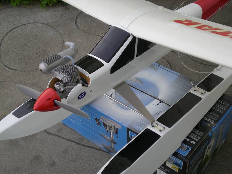

my Nextar has a OS 61 and floats putting a overly large engine on this airframe isn't going to help that much,unless your planning for the future if thats the case then get a 46-55AX after you save a few more $$, instead of spending less in the short term, get the best possable engine you can.this is just a floaty trainer not much of a stunter
