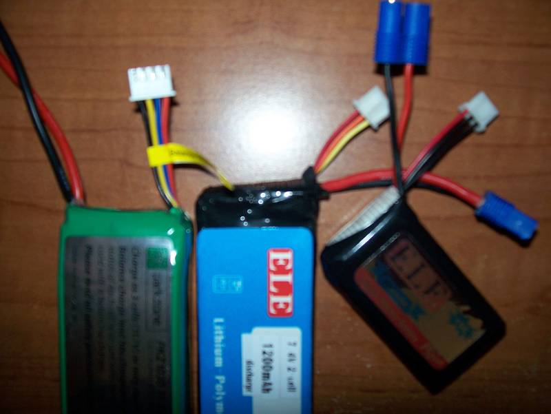

I'm getting ready to order the electrifly equinox balancer, and I was wondering if the balancer will accept my leads on my LiPo's here I have a picture (sorry about the quality) I have my 3S wich has a 5 prong lead, and two 2S with 3 prong leads. Will I have to buy lead adapters? If so were can I get them for my battery applications? thanks! Also I just found that my 3S pack being made by parkzone it has to have the parkzone balancer/charger. I have EC3 connectors on all my batteries, so does anyone know if this charge automaticaly balances/charges your packs? Or are all charge leads to 2S and 3s the same? I know thunder power's leads aren not.

You have to use the balance plug to balance the batteries, it can't be done through the EC3 connector.
No your parkzone battery does not have to be charged/balanced with parkzone charger. Any quality charger/balancer will work fine.
There are 2 different size balance connectors (not talking about pin count but physical size) one is Thunder Power, the other I am not sure of the name but most other battery manufacturers use it. The second, larger size, is probably what fits the Equinox balancer and probably what you have on your batteries now. You would probably need an adaptor for Thunder Power batteries (the polarity is also reversed on Thunder Power)
Notice all the "probably"s in my post.

Yes it works fine.
I have one and I've used it for the Parkzone and other batteries.
Provided with the Equinox you will find multiple connectors.
You can also order others for different cell counts.
I believe it comes with a connector for 2S, 3S and 4S.
