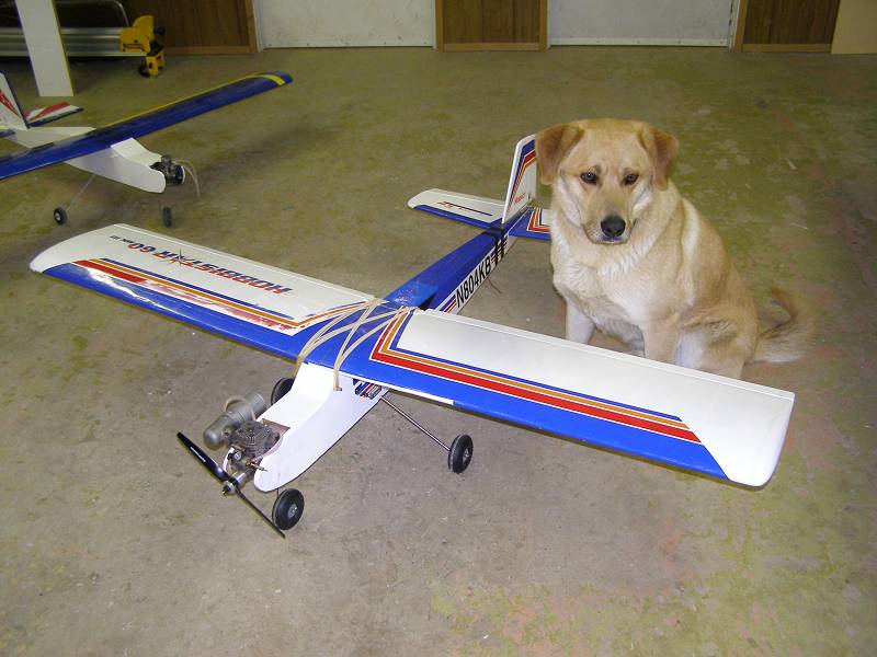

hey guys...on my hobbistar 60 airplane i'm having with the front nose gear. the spring thats located half way up the steering rod wears out and gets all flimpsy. so when i accelerate to take off and make steering corrections that steering rod bends over about 45 degrees and the plane is uncontrolable. so i'm wondering what i can do to beef that up cause i've already replaced it a month ago and that one is done already. i'll throw in a pic of the plane if that will help you.

One way to fix the problem is to get a FULTS dual strut nose gear. They make them is various sizes. Check Tower Hobbies and see what they have. The difference between a standard nose gear and a FULTS dual strut is like night and day. Todd

This is a common problem and one quick fix is to turn it around 180. also ask around the club as most flyers will have some of these laying around and a relpacement is often there for the asking. watch at swap meets and sales, it is easy to pick up stuff like that cheap. If one of the guys helps you out just remeber to do the same for the next new guy!

"sawdust" has a good idea. Fults makes an excellent nose gear. Your gear is probably soft, not-heat-treated steel that will bend and stay bent easily. Typical of a "Pacific Ring" ARF.

See if you can find one that's been heat treated or of better quality. The trick will be finding one with spring but not so much that your firewall starts getting stressed from the hard landings. I've seen some guys get frustrated like you're getting and try the dual spring gear and take a hard landing then find the firewall broken or cracked.

The fults dual nose gear is a tad heavy. So, after you install it, re-check your CG. It may (probably) change.

Hey, you might consider that the nose gear bending is a good thing. The energy from a hard landing has to go somewhere. The gear absorbs it now and bends. If your gear is strong enough, the force is transmitted to the firewall. The firewall is a lot tougher to fix.
I just kept turning the gear 180 degrees when I bent it. Eventually you'll start making "purty" landings and you won't have to worry so much.

This is one of the easiest tail dragger conversions out there, just mount some lite ply on the fuse sides and use 1/4" ply for the plate. Mount it up tight to the former, and your gear will be right on the leading edge. Use this tailwheel, great way to jump into a tail dragger.

i do occationally get a hard landing but for the most part they are good. its not the landing that wrecks em, its the hard uneven surface that i land on that causes em to weaken.

Then you will like the Fults. They have a bigger upper wire that will require drilling open the gear mtg holes but worth it.
