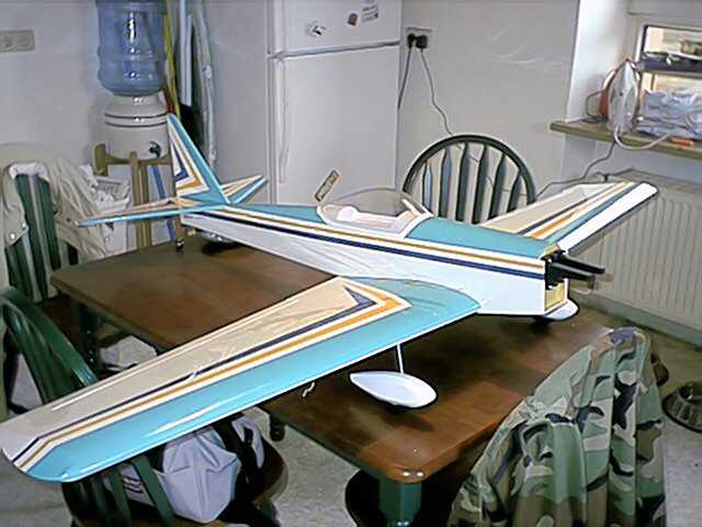

I'm in the middle of the construction of my first plane. The cloud dancer 60 has gone together quite easily, the only thing I have left to do is the instalation of the radio and servos, the engine and the cg balance. i will also be installing an FMA co-pilot. My question is about the cowling: what's the best way to cut it? I was thinking I could use a Dremel with a small grinding attachment to make the shape I need. Ant tips or suggestions are welcome.

Using a Dremel with a small grinding bit is exactly how I cut openings in cowlings.
I also mark a line on the fuselage where the cowling will be seated. Then I tape a piece of heavy paper behind the cowl attachment line. I make the engine cutout in the paper. I remove the engine and install the cowl. The paper is then used to trace an exact outline of the engine opening on the cowl. I make the cutout into the cowl and I have an exact opening perfectly matched to the engine.

I haven't seen the cowl on a Cloud Dancer yet, since the one I ordered has not arrived yet. But one thing I have found that helps get a smoother cut is to spread a little bit of thin CA on the inside of the cowl before you start grinding. I also use my dremel and the paper template method mentioned by John Norton. I find that the CA minamizes the number of loose and peeling fiber glass strands I end up with around my freshly cut cowling holes.
