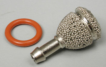

Although Dubro (I think it's Dubro) makes a less expensive one than this
http://www3.towerhobbies.com/cgi-bin...&I=LXXF25&P=ML
I use this sort of thing for two reasons: to reduce or prevent foaming in the fuel tank and to act as a filter, if I realy need one. It's there and works fine.
I found the Dubro one.. here it is:
http://www3.towerhobbies.com/cgi-bin...?&I=LXD741&P=7
CGr.

CGr, I have shyed away from this type clunk, thinking that as the fuel got low, it would start mixing air with the fuel as part of the filter would be above fuel level. Do you run into any issues with low fuel with this. I always though it would be better to have the single small inlet that would either pick up fuel or air, kind of a binary delivery. Maybe I'm borrowing trouble and missing out on a good idea???
Don

I've used the sintered ( sp? ) bronze ones to help LOWER fuel foaming problems which they are advertized to do.
They work very well at this.
I compared using one of these on a tank which was being subjected to vibration at a specific RPM. With a standard small hole clunk I'd get foaming... with the sintered brass clunk, no foaming.
The brass clunk is supposed to break up any bubbles.

Yeah, the reason I started using them is for that very reason. I think it was all started with my Excellerion 90 and that crap Evo 100 NX engine. It was a suggestion to try to fix the problems I was having with this setup. So, I went ahead and replaced the clunk. It did not fix the problem but I left it in.
Eventually, though, the engine was replaced with an OS 1.20 AX and the problems went away, but I kept the clunk in there and it has not caused any problems at all. But, I always try to remember to time my flights so I don't run low enough on fuel to see any problems as you mentioned.
Since then, I pretty much just install them in my planes. It's one of those things, I guess, that we gain confidence in for one reason or another, and even though there is no logical reasoning behind this, we continue to do so.

After many, many years of building tanks and competing in an event where the flight time was VERY important and there was no throttle, and trying lots and lots of designs..................................
The type CGRetired suggests is excellent. It's got a huge filtering area and does seem to insure no bubbles from foaming fuel for one. What you've suggested, having just a single small inlet is a good idea too. But what you are worried about actually doesn't seem to happen.
What happens with any inlet is that the very instant it is uncovered it will suck air. Size doesn't matter. As soon as the fuel level uncovers the inlet, you're out of gas. The tank won't ever be, but the engine will be. A small inlet will be able to pull a higher percentage of the fuel out before it sees air. A larger inlet will leave more fuel in the tank. In theory, the big inlet should be more apt to cause a stumble just at empty. In practice, it usually doesn't. And when it does, it's just a stumble, not a lean run. And that is actually a good deal, not a bad one.
The filter CGR advises is a good idea for sure.

I think I remember that thread too... that's the reason I started using them as well. Never got the Evolution 1.00NX to work right, but I'm about to try again... this engine really bugs me...
I didn't quite believe in those clunks until I had a foaming issue in another plane which the Dubro clunk eliminated. They also prevent problems if your lines are just long enough to contact the back of the tank on acceleration.
I had a plane that I had setup with what I though was enough of a gap, and it turned out that as it accelerated the tubing would stretch just enough to let the clunk contact the back of the tank, causing an overly lean condition and deadstick.
The Dubro clunks prevent this from even being a possibility.
