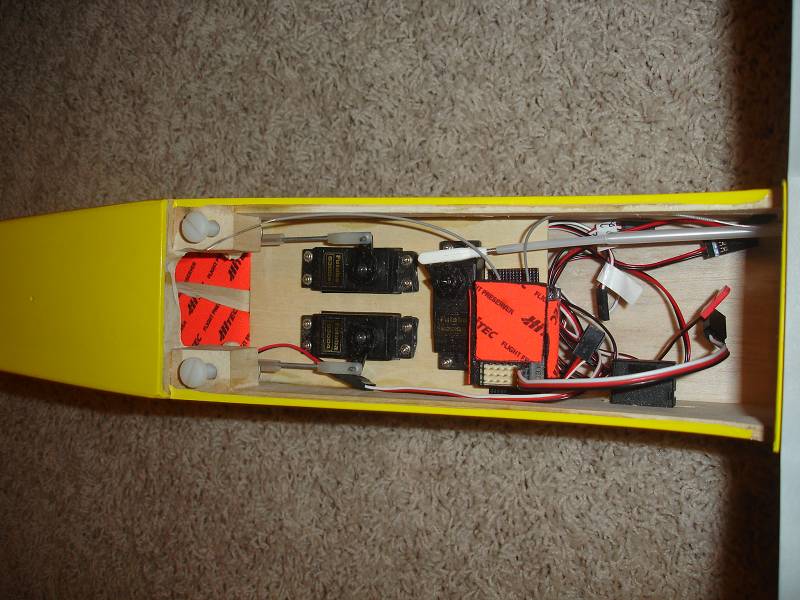

I have a four star .40 and Im using a OS 46AX engine on it. The way I have it set up right now is with the battery foward of the servos but as far back as possible and Im still quite nose heavy. Today was her maiden flight and I had to trim the hell out of the elevators to keep her from wanting to dive. And rolls were everything but axial. So Im trying to find out if any of you have the same engine on this plane. I was thinking about putting the battery behind the servos to balance the plane. I was just wondering if anyone else ran into the same problem with having this plane nose heavy and if you were able to balance the plane with battery placement or if you had to add weight to the tail. Also, I was going off of what the manual says for balancing.

You can indeed move the battery to the back of the servo's to obtain the proper balance. Just make sure that you do not get it tail heavy. Good Luck, Dave

You don't mention where the CG actually is. Have you measured where it is? The building plans will give a CG range. What is that, and where is yours?
It's not strange for ARFs to come out with lousy CG's. The workers over there aren't modelers. And they have proven to know nothing about wood selection. So it's not uncommon to have nose heavy or tail heavy ARFs.
If you look at the picture, it shows a battery installation at the farthest aft the battery can be and still be inside the equipment bay in the fuselage. The blue piece is foam insulation I used to box in the battery for that airplane. You'll notice that it's directly under the aft hold-down bolts that go through the trailing edge of the wing. A couple of ARFs have required placing the battery even farther aft. I've built battery boxes back inside the aft part of the fuselage. You're limited only by how far the switch/battery wiring will reach. You do need the box structure back there because the fuselages aren't designed for that much weight back there. But it works.
After seeing how often ARFs wood selections have screwed up the balance, I now delay placing the switch harness until I can do a preliminary CG check.
So tell us where your present CG is, and don't worry if you need to move the battery back.

As indicated above you need to find out where the CG is. Below is a shot of where I had my batteries when I had a 46AX in my 4* 40-Behind the servos. I also had a Dubro Isolation engine mounts which add more weight. If you can't get the CG back far enough, move your engine back or try a APC prop and heavier spinner.

I have exactly the same plane(ARF)engine......also had the same problem.I moved the batt. behind the servo tray and problem solved.I used a piece of velcro to secure.

I just got done moving the battery behind the servo's, I went to check the c.g. of the plane and if I try to check it right side up, going off of what the manual says and using the main wing spar as the c.g. point the plane is tail heavy, but if I check the c.g. with the plane inverted on the same spar, the c.g. is perfect. It sits nice and parallel with the ground. What do you guys think?

If it balances upside down, and the CG is where the manual says, then you're good to go.
The manuals usually suggest a CG range. If the model balances anywhere in that range, it'll be stable in flight. The suggested CG is really only a starting point to get you into the air with some assurance the plane will be controlable.
And it sounds like your 4* balances.

Glue a piece of wood across the fuselage back there and use a zip-tie around the wood and battery.
