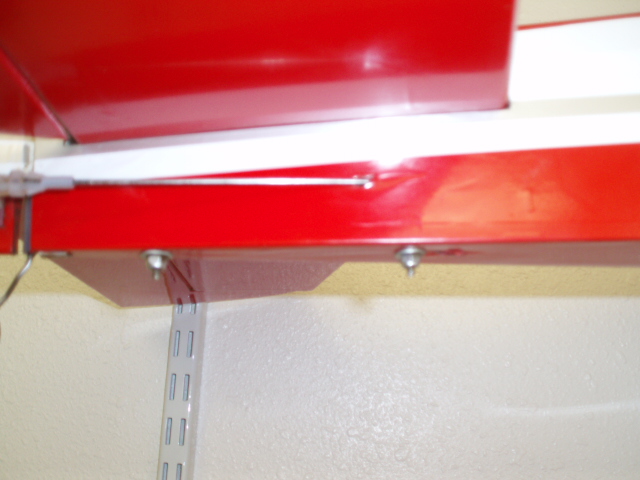

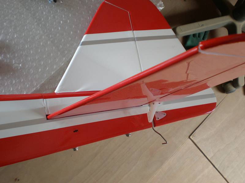

I am in the middle of assembling the pulse and noticed that the bolt on tail section will not tighten up snug to the fuse because there is a gap of about 2mm between them. if I lower the tail section to close the gap the wing section and the fuse will not be flush on top. Any body have this problem and how did you solve it

Hope these pictures help explain

If anything it appears that you have the tail bolts on too tight, which is deforming the rudder and it's base.
Do this...
First loosen them up a bit.
Then check the elevator.
Does it move up and down, or rock from side to side when you push on it?
If so get some saddle tape ( or any thin foam tape will work if you cut it down ) and put it on the elevator.
Then put the bolts back in, but apply loctite BLUE to them.
You should have no up/down play in the elevator nor should you be able to rock the elevator from side to side.
That gap at the front is unimportant.

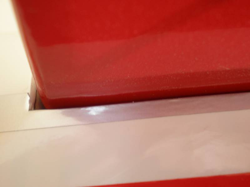

I have attached some pictures of my pulse. It has about 200 flights on it. Just a great plane to fly. Anyway, I don't think you have a problem. What opjose said is what you are looking for. Mine has nylon lock nuts, looks like yours does too. I didn't use any thread lock, and they have not loosened up at all. But like the manual says, don't make them too tight.
