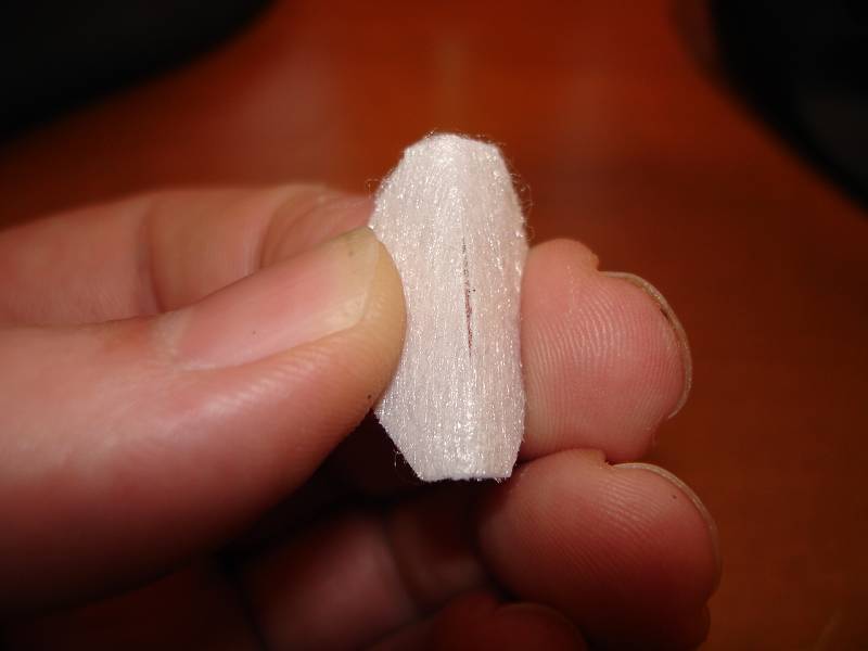

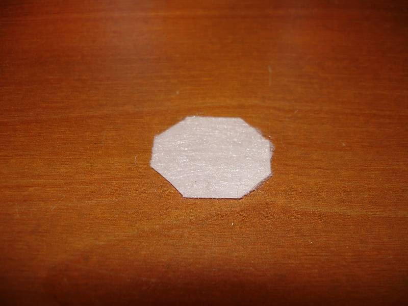

Hi all, I have a quick question about the hobbico CA hinges that came with my avistar kit. These 1" X 3/4" hinges have a slice through the center along the 1" length. Which way should I install these into the hinge slots. Thanks

The slit in the hinge goes perpendicular to the hinge line. It's there to help the CA wick all the way into the hinge.
Another way to say it, they go in so their long axis is perpendicular to the hinge line.

You want to install them with the slit in the hinge perpendicular to the trailing edge of the wing/stabilizer. Slide the hinge in so tha the slit is sticking out. The slits are there to help the CA to wick into the back of the hinge.
For more help on installing CA hinges check out Minnflyer's How-to on CA Hinges:
[link=http://www.rcuniverse.com/magazine/article_display.cfm?article_id=55]Installing CA Hinges[/link]
