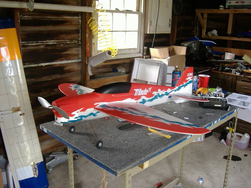

Thought some of you gents with low wing experience might like this one. It kind of an alternative
to flat plate foam planes. My wife bought it for my B'day and after all the great stuff i have heard
I figured I give it a shot. 18oz weight, 39 inch wingspan and 44" fuse length. Made of a depron type foam,
full fuse and airfoiled wing and vertical stab, with a flat hotizontal stab. I've been told on low rates it's
a gentle flyer and glides in for a nice landing. Called the E-flite tribute FX.
I have about an hour of work into it and it's coming along quite easy. Simple build, very straight forward.
I was going to do a setup and assembly thread but I don't feel it's a beginners plane, maybe a second or
third after a proper trainer.

Yeah, that one will be pretty aerobatic once you've got it ready to maiden. It looks like it's coming along nicely, though. Be sure to let us know how you like it after the maiden flight!

boy that looks like fun . dont try and fly it as a first plane because you will crash it after about 5 seconds go to a club and tell them what you want to fly and ask them how you can work your way up to flying it.
good luck with it and happy flying

Nice job, Chris. Looking good!!!

I took my amp readings saturday morning and was pulling 16 amps at full throttle with a 11x4.7
slo flyer prop, Castle Thunderbird18 esc, and E-flite park 450 motor. Went out to maiden today
in 10MPH winds. Charged my new 1300mah 3s1p packs and did a contol check, all looked good.
set the plane on low rates and advanced the throttle and it took 3 ft to go airborne. Once in the air
it took 4 clicks of up elevator to fly level at 1/2 throttle. I flew around for about 2 minutes and the
little guy was great, very gentle on low rates and animalistic on high rates. I decided to do some
wind surfing and slowed it down to about 2 clicks of throttle and just hovered about 12 feet off the
ground. I also tried my hand at knife edge wind surfing, although hard it looks awesome to see a plane
stalled in the wind on a knife edge.
I was having a ball when the motor started acting weird, speeding up and slowing down on it''s own.
then it just shut off. I had to make an emergency landing with no forward momentum, and only the wind
holding it up. I got it down safely and while walking over the surface controls died also. upon further
inspection the ESC burned out. This was the second time I had problems with this ESC and it just came
back from being repaired. I checked the RX and all is good. I threw away the ESC and getting a new one
tomorrow.
Other than the fried ESC the plane flew very well, even for an 18oz plane in 10MPH wind. I can''t make
any reccomendations on it as the testing wasn''t long enough but I think she will be a winner.
