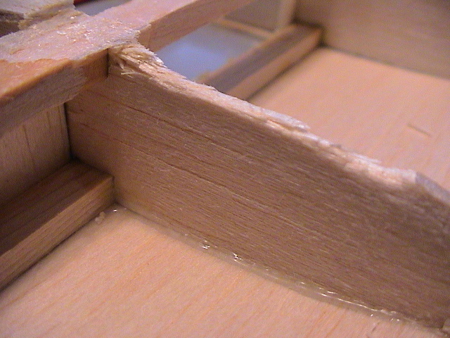

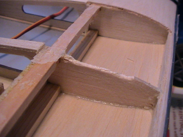

[img][/img][img][/img] Here are the pics you asked for. The rib with the top chipped out of it is where the impact was centered. the balsa across the top was shattered 2 inches to both sides. It had also broken out the brace behind it on the (root i believe) and it was in several pieces. All I have removed is the section across the leading edge. everything else is as it was when I removed the covering.

Piece of cake.
First, the crack in the rib ib picture 3 you can just glue - nothing fancy, just glue it. Thin CA will wick right in, or you can spread it like you''re doing in the picture and put a little medium CA or wood glue in it.
For the front of the rib, get a piece of balsa scrap and glue it along side the rib. Then sand it to shape. It won''t matter that it''s a fraction of an ince to one side or the other.
To re-do the sheeting, have a look at this:
[link=http://www.rcuniverse.com/magazine/article_display.cfm?article_id=98]Sheeting repair[/link]
Old 04-16-2008 | 12:01 PM
RCKen's Avatar
RCU Forum Manager/Admin
Posts: 28,241
Received 31 Likes on 27 Posts
From: Lawton, OK
Default RE: In need of some repair advice.
Ok, these are actually some very simple repairs. For the rib that is cracked that has the cap strip on it (your last picture). Press down on the top of the cap strip to close the gap in the broken area and simply wick thin CA along the cracked line. Keep pressing down until the CA "kicks" and sets. For the other broken rib. Do you have the "chunk" that came out of it? If so simply glue it back in place with thin CA. If not, it''s still no big deal. Using sheet balsa cut a piece the length from the spar to the leading edge. Now place it along side a good rib and trace out the top curve of the rib. Cut along that line to get the same shape as the top of the rib. Now glue this piece in place along side the rib with the chunk missing out of it. Now re-sheet the area over that rib. Simple and your done. One thing to remember when doing repairs like this is that ribs are not a structural part of the wing. Meaning that they aren''t load bearing. The purpose of the rib is to maintain the shape of the airfoil. Many times people will over engineer repairs to a rib because they think it has to be strong, which just adds unneeded weight. All you need to do it put components in place that will maintain the shape of the wing.

Is it just me, or is there a crack in the top spar visible in the first picture?

Nathan,
I don''t see a crack in the spar. I see a line just to the right of the damaged rib that looks like a crack, but if I look at picture #2 I can''t see that it''s gone across the spar. But it would be a good idea to double check the spar to make sure that there aren''t any cracks in it.

ORIGINAL: RCKen
Nathan,
I don''''t see a crack in the spar. I see a line just to the right of the damaged rib that looks like a crack, but if I look at picture #2 I can''''t see that it''''s gone across the spar. But it would be a good idea to double check the spar to make sure that there aren''''t any cracks in it.
Ken
Oh, nevermind. It''s just the edge of the glue residue... carry on! [sm=red_smile.gif]
