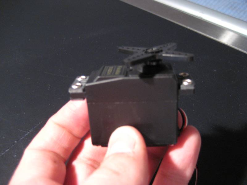

Hi.
I''ve seen a couple of different ways of installing a servo. What would you consider the best way to install the serve using the rubbers included? The way on the left with two rubbers on, or the way to the right with only one rubber on top? Or perhaps a totally different way?

Rubber on top AND bottom
PS, you have the brass eyelets in upside down

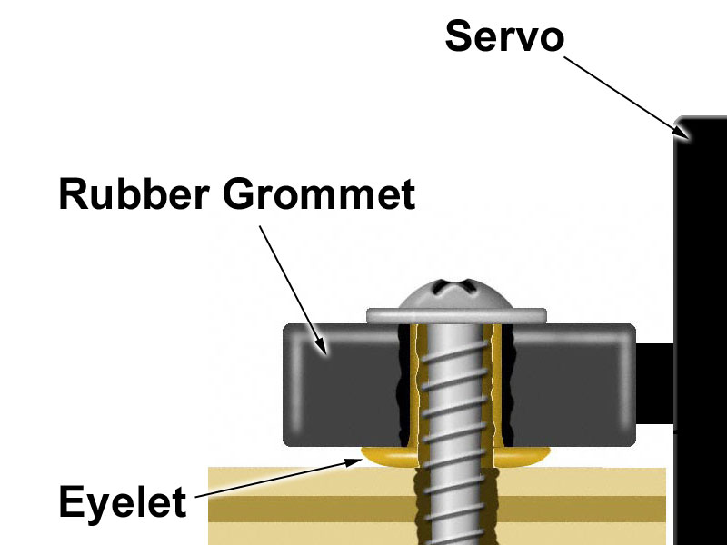

FatOrangeKat, Do NOT omit the top rubber.
Place one rubber on top and one on bottom. Push the brass eyelet up from the bottom (A jeweler''s screwdriver or other small tool is a big help here)
Then place the screw through the eyelet from the top as this picture shows (This picture shows a different type of rubber grommet, but you''ll get the idea

What Minnflyer said. The rubber needs to be on the top and the bottom of the mounting flange. The other huge mistake that made quite often is that people will crank down the servo mounting screw as tight as they can. This is a sure fire way to servo failure. The screw needs to be tightened just to the top of the rubber grommet, and no further. This is done to ensure that the rubber grommets absorb vibrations from the airframe. If you over tighten it the rubber can no longer absorb the vibrations and they are then transfered directly to the servo, which will lead to servo failure.

ORIGINAL: MinnFlyer
Place one rubber on top and one on bottom. Push the brass eyelet up from the bottom (A jeweler''''s screwdriver or other small tool is a big help here)
Then place the screw through the eyelet from the top as this picture shows (This picture shows a different type of rubber grommet, but you''''ll get the idea
This is the way I was trying to describe in my post a ways back.
